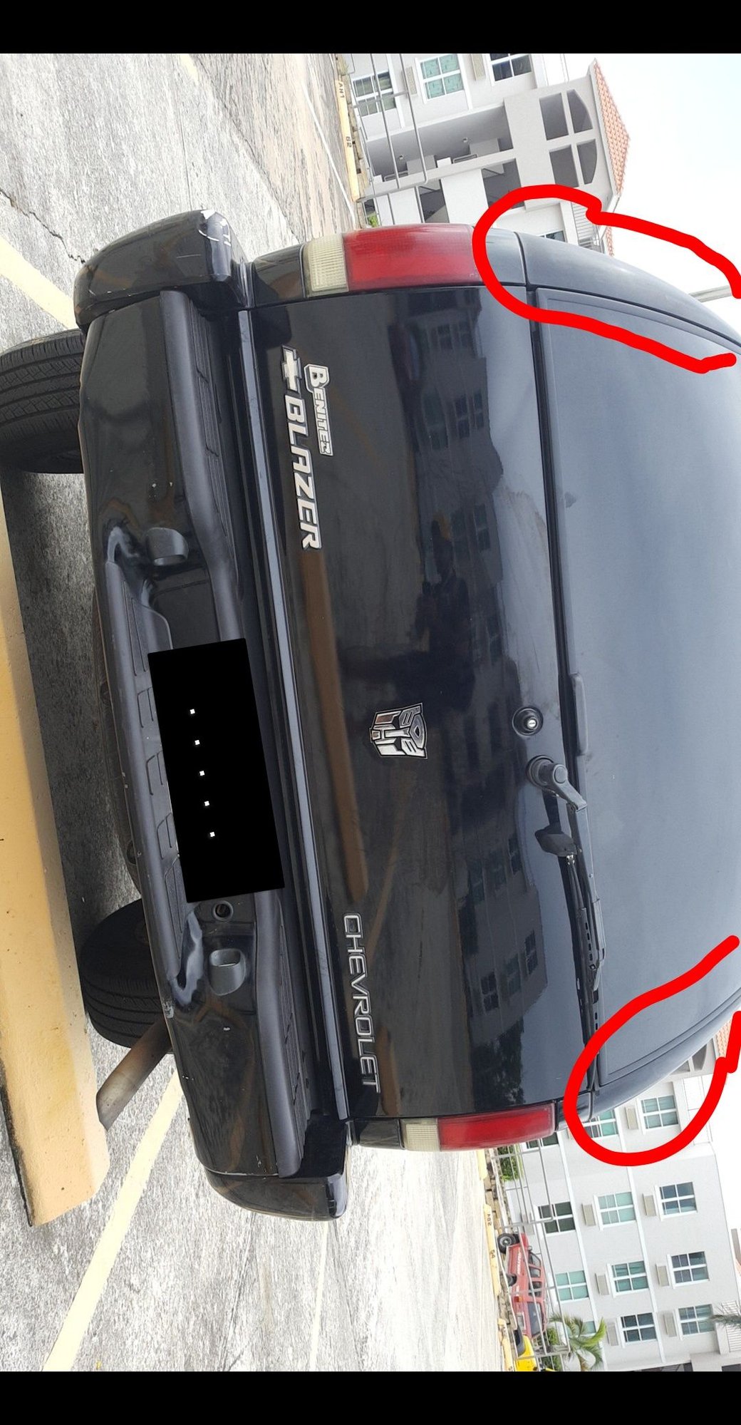

Default Back side panel?? WHAT ARE THESE CALLED
WHAT ARE THESE CALLED? I CANT FIND THEM ANYWHERE
Old May 8, 2020 | 12:05 PM
Don't know what the actual name for them would be, but I would call them the exterior upper quarter trim panel if I were trying to describe it to a salvage yard or someone like that parting out a vehicle, and explain to them it's the plastic panel just above the taillight and just behind the quarter glass.
​​​It's worth noting that they're different between the rear hatch style and tailgate style 4 door configurations. The hatch style has them mounted to the hatch, the tailgate style their mounted to the body, and they completely different and are not interchangable. Other than that I believe they're the same from 94 to 04. 2 doors are a different animal all together though, as that trim piece is actually the quarter window frame.
