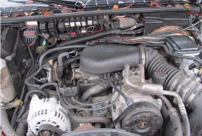

I purchased my relays and the supplies for the relays, the relay box, and the GM style connectors (Metri-Pack 150) from Del-City and Terminal Supply. The flip-flop relay came from eBay as did the fog-light button and pigtail for it. My relays are going under the instrument panel but if you want to install any in the engine compartment, you'll want to have connectors and relays that are at least weather/moisture resistant.
As for places to install the relays, I've seen relays nicely mounted to the top lip of the engine compartment firewall. You can either get a nice box for them all or you can, for the Bosch style, get the relays with their own mounting flange.
Regarding the relays with different terminal sizes, I've been able to infer that they will have different sizes depending on their maximum current rating.
The most common automotive relays are the "Bosch" style that have control-coil voltages of 12V-14V and ratings up to 40 amps for the switched part. These have 0.250" wide terminals. By mistake I purchased a relay rated at 60 or 80 amps and it had wider terminal blades
