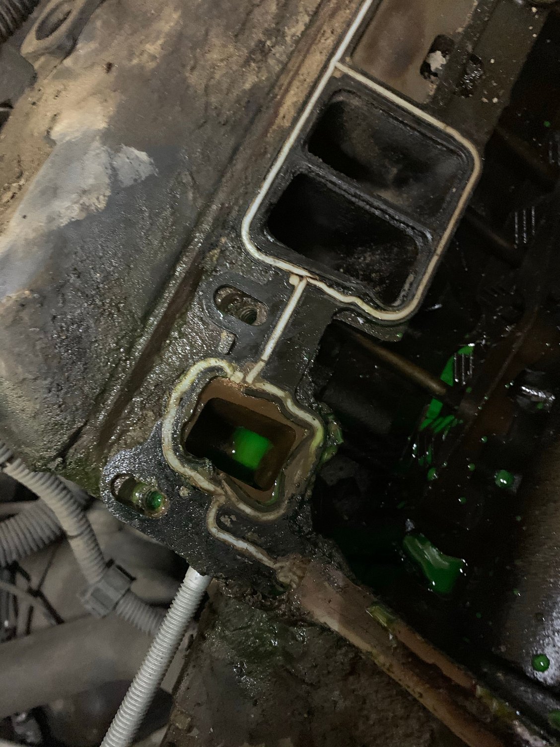

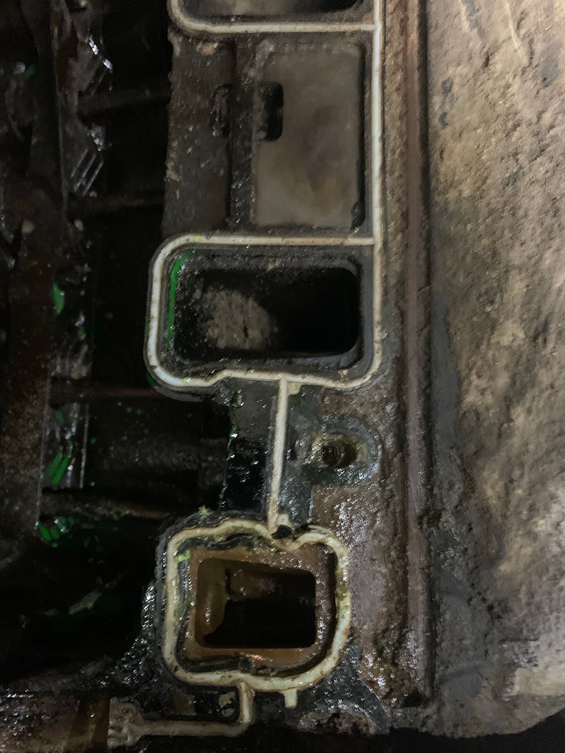

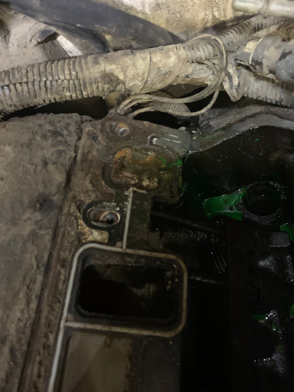

Mine was doing that before I did my gaskets it would seep out and burn a tiny bit not enough to throw any smoke but seeped enough that I put dye in and it was all over the front of the block and along the intake when I finally did the gaskets I noticed the dye in the oil it had just started to leak more

300k km and stock gaskets they fell apart in pieces
found it more tedious then difficult a lot of stuff to move out of the way and having a shop vac helps

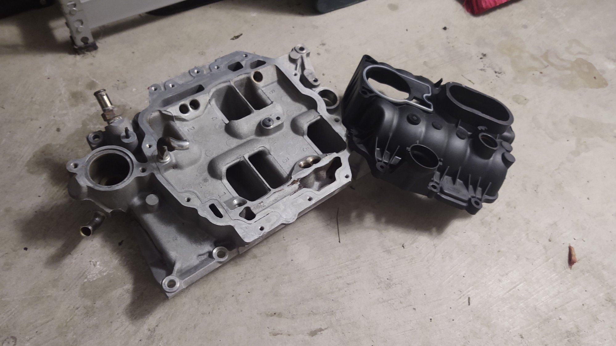

Took my "new" replacement intake manifold to work today and hit it with our strong degreaser and bad @$$ pressure washer. Going to tackle it's replacement Saturday evening hopefully (gotta work Saturday morning, so there's a good chance I just won't feel like messing with it after work, we'll see lol)
that intake doesn’t look like it has egr is it possible to change the intake to a non egr cause I have egr on mine but I have 2 extra intakes and one is non egr
I'm not really sure. My 04 doesn't have EGR, thus why I acquired this intake to replace the one on it now with the broken thermostat mounting flange.
I would only imagine that you could, then just plug the EGR pipe on the exhaust manifold or replace it with a manifold without the EGR pipe provision. Not sure what you would do about the electrical connectors though, leaving them unplugged might throw a check engine light on?
I’d just leave the egr valve plugged in and tucked away lol
