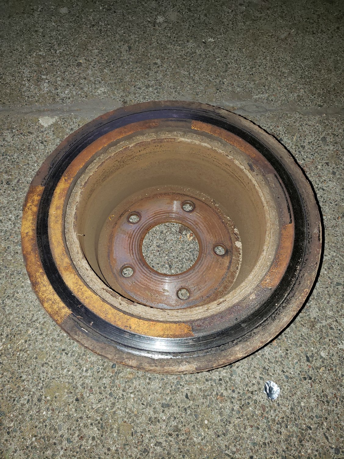

New rear brake calipers, rotors, and pads.
Lesson learned: Don't take your rear brakes for granted and check the lubrication on those guide-pins!
https://blazerforum.com/forum/builds...e7/#post735671
Just a bit of a gouge in the rotor. LOL
Just went through a similar issue on mine, though my rotors didnt get trashed out thankfully and i've fixed it since. though my front brakes are also trashed out which i still need to fix lol. The Slide pins i had to beat out with a 24in prybar and a BFH.
