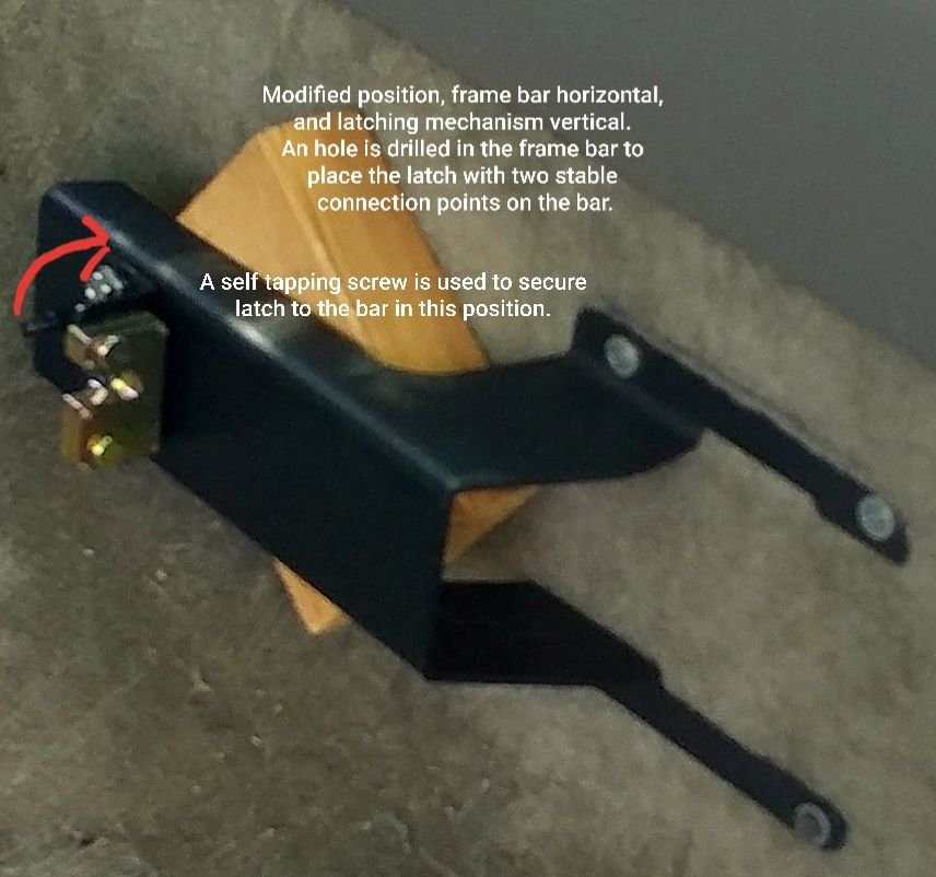

Hello, I am new to this forum, but thought it would be useful to some that carry tools or things and just don't like them thrown in the floor or back. I have had tool boxes that just slide around, if not secured, when in the bed of my pickup, or such that extend across the bed rails taking up bed space. But I found that the swing case boxes that attach to the inner sides of the truck bed on a hinge to swing out to the back are useful for space saving and pretty durable for most tools and small item you don't want just laying lose.
So I thought why not in the back of my blazer instead of just a box or thrown back there. I took one from my truck bed and matched it to the inside right prefect. But swing case don't make them for SUVs, necessarily,. I found that the metal frame behind the plastic moldings in the rear of our blazers make suitable places to tap and hold the same way in most truck beds. So I took the frame hinge and latching bar mechanism from a 2017 f250 and matched them at the necessary height and depth to secure the box to swing. No relative mods to the interior of my blazer other than a 2x4 piece for more firming against the side wall. I only turned the rod latching mechanism on the frame bar from horizontal on the wall mount to vertical. Drilled in one self tapping screw in the frame bar to hold secure the latch.

I am really liking this upgrade. Currently I use a storage tub with my tools but this is much better.
Can you post a pic of how you had to modify the latch mechanism on the box?
Edit: I figured out what you did with the latching mechanism!
Sorry the first pic didn't enlarge as I though it would on upload.
The main idea is to keep the latch in a vertical position.
The frame bar is meant to be in the vertical position, but
in our blazer application it will only work and match metal
screw tap points behind the plastic moldings.
