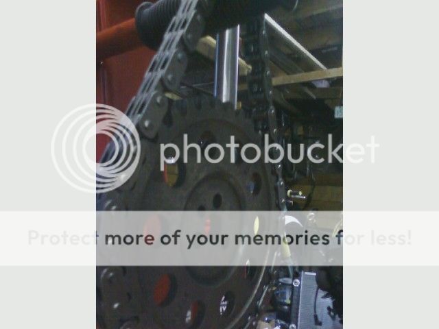

Finally got started on my half-assed (just gaskets, oil pump & timing set) engine build.
Installed a Comp Cams timing set yesterday. It's amazing the stock set lasts as long as it does. It's about 1/3rd the weight & thickness of the Comp setup! I shouldn't have to EVER replace this again.
Had about 1" of slop, so it was a ticking time bomb ... and even more so since it's carbureted, and doesn't always idle smoothly when first started. That puts a load on the set that it wasn't designed for, since this engine was designed & built for FI only.
Next up for today - clean oil pan, & plastic timing cover, replace seal in cover, re-install, then check oil pump/screen clearance to pan & crank.
Comp Cams setup:
Stock vs. Comp -no comparison!
