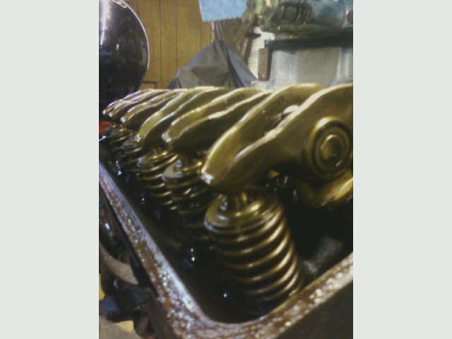

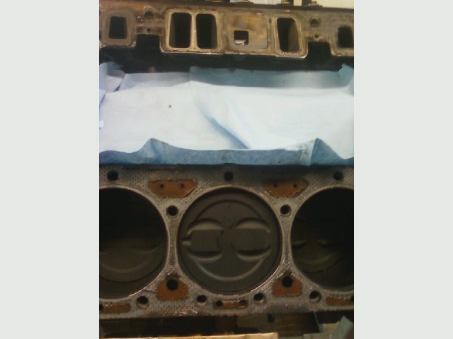

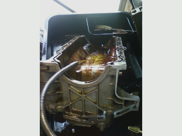

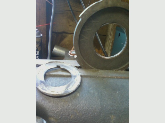

Finally got the barn roof all finished a couple weeks back, so making some progress on the engine here. Timing set is all installed, cut the center of the CKP sensor reluctor wheel out to save weight & still have the proper clearance for the harmonic balancer, got the cover back on, cleaned out oil pan, returned my HV oil pump for a stock one (couldn't get proper pan clearance), removed the left side head, cleaned all gasket surfaces, & began installing valve seals. Still quite a bit of work left, but getting closer to re-assembly.
Was surprised at the lack of carbon in the engine. Alot of that is probably due to the previous factory FI, but we've put about 10k carbureted miles on it. Guess my tuning is spot-on.

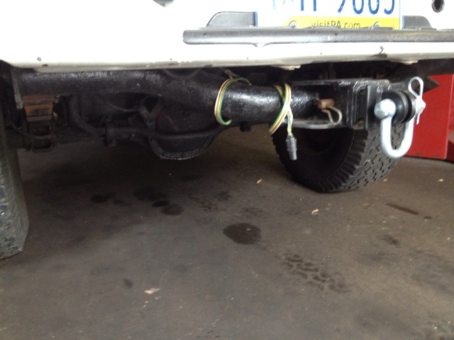

Wired in a plug so I can add it to the list of useable-for-actual-trailers hitches available (primarily for SpoonPlugger-the 'community' fishing boat)

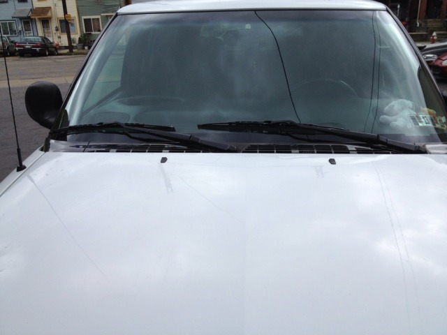

painted the faded wiper arms
(well it's chip guard... same thing. It was the right color)
