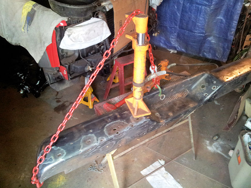

Default Straightened rear bumper, Gas Tank & Lines, Ball Joints & Axle, Headers, Polish Rims
Sorry this gets long winded, but that voice in the back of your head keeps saying "fix it while you have it apart" or you'll just have to do it again.
Had to get the Bow out of Bumper before painting, and found

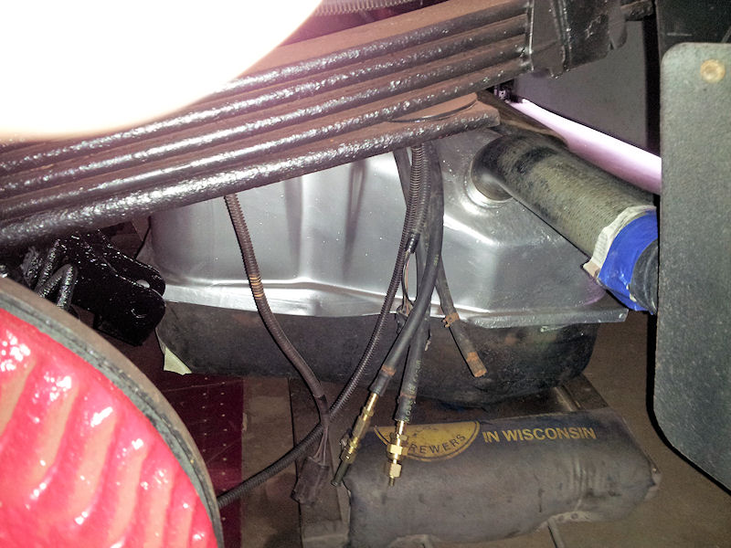

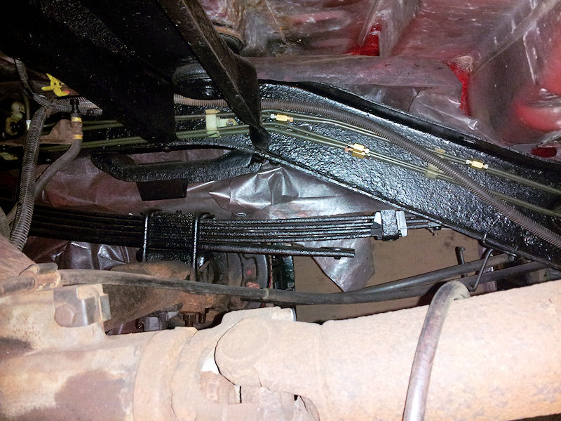

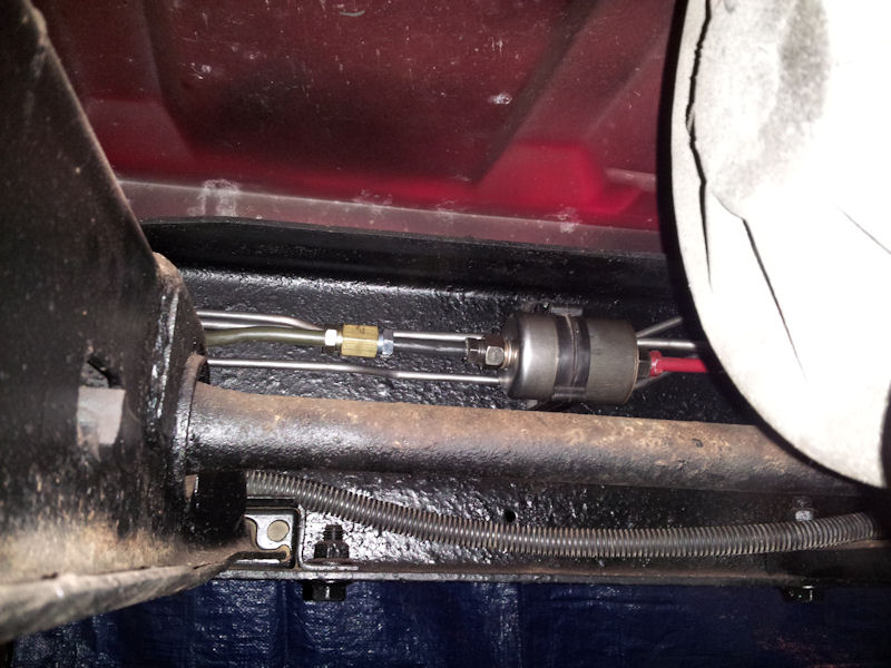

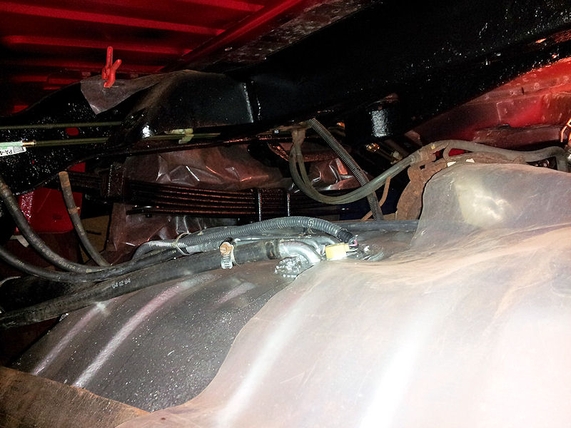

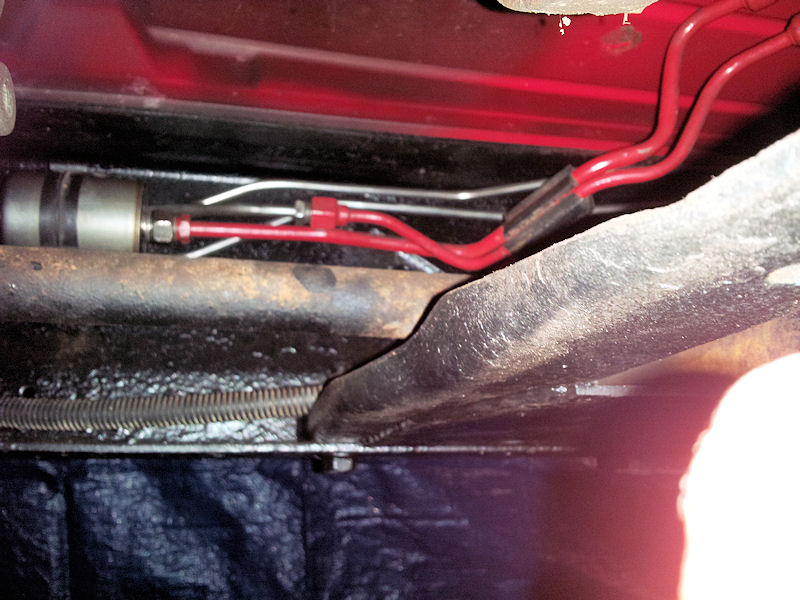

Rear Wheel cylinder was Leaking, and This lead to replace rear Brake line & Wheel Cylinders, which also lead to Dropping the Gas tank to fix the fuel Lines that now were leaking trying to fix the brake line.
Dropping the gas Tank involved removing the Trailer Hitch, and here we are back to where I started with the bumper.

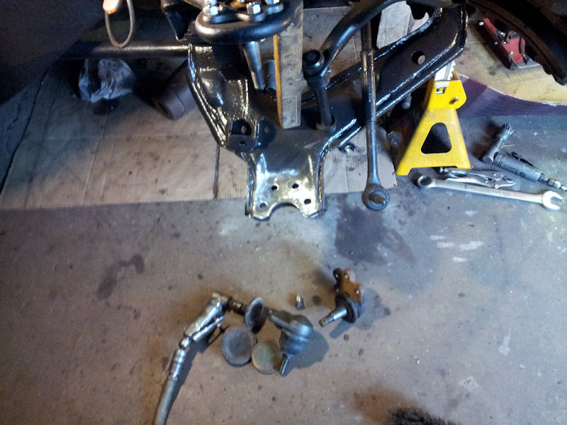

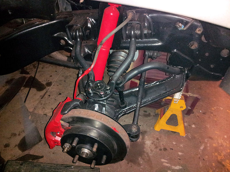

When I got tired of laying on my Back installing the Lines, I tore the front Disk Brakes off to check them, found a bad hose and a broken ABS sensor wire, oh and the CV Boots on Both Sides were bad, leaking Grease, Unbolted front axles and having a PIA to get them out, well I took a pry bar to check the ball Joints Uppers were not that bad but the Boots were shot and RH Lower was not good, now remove axle spindle, to get axle out and replace the Ball joints with Moog type.

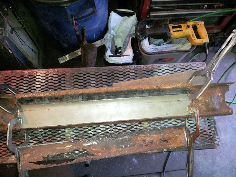

Back to running lines and after cleaning up the Gas Tank & spraying with rustolium Aluminum, found Rear Gas Tank Frame bracket rusted through, chiseled out rivets, removed brace, cut out rust & welded in a fabricated piece. Drilled out rivet holes and installed Frame Bolts, and remounted Gas tank Support Brace.
Completed the Lines from Carb to Tank, and cut the GM Press Fittings of the Tank Hoses and Used a Compression fitting for the line with a ****** fitting for the Hose, had to remove shock to get room between the Tank and the Frame Rail to do the Final Line Compression connection.
That done Now completed the front Axle & Spindle install, Fixed caliper Hose and PNP ABS Sensor, Heated Bleeder screws and worked them loose so I can now bleed the lines.

That Done and Brake Unions Tightened up I now have no leaks in the Brake Line.
To Check the Fuel Line I turned the Key On and the electric Pump would run for 5 sec & shut off, did this multiple time and No Leaks - Yea.

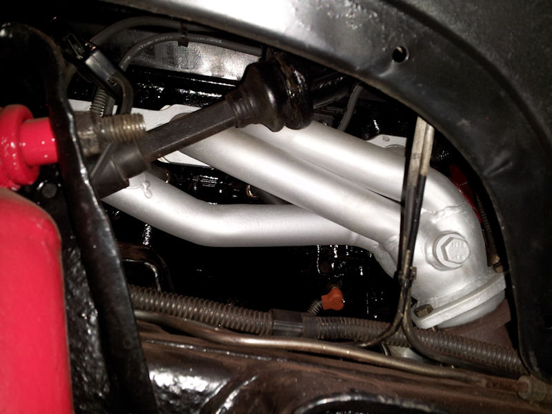

I installed the shorty headers & fabbed up the exhaust, welding hanger brackets to exhaust and Clamps. Oh i replaced the TBI from my donor Truck, as the existing one was leaking and corroded, when I ran the lines.

I sprayed the Frame and other parts with rustolium semi-gloss black while I had all the lines and tank out.

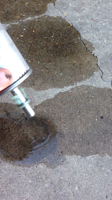

changed my oil today. took the valvoline maxlife out and put in some royal purple and a k and n oil filter. running smoother than it was, so i'm sure it was time for an oil change. even though it was neither 3 months, or 3000 miles.... went ahead and changed the fuel filter too. its starting better, and started running even smoother than with just the oil change.
