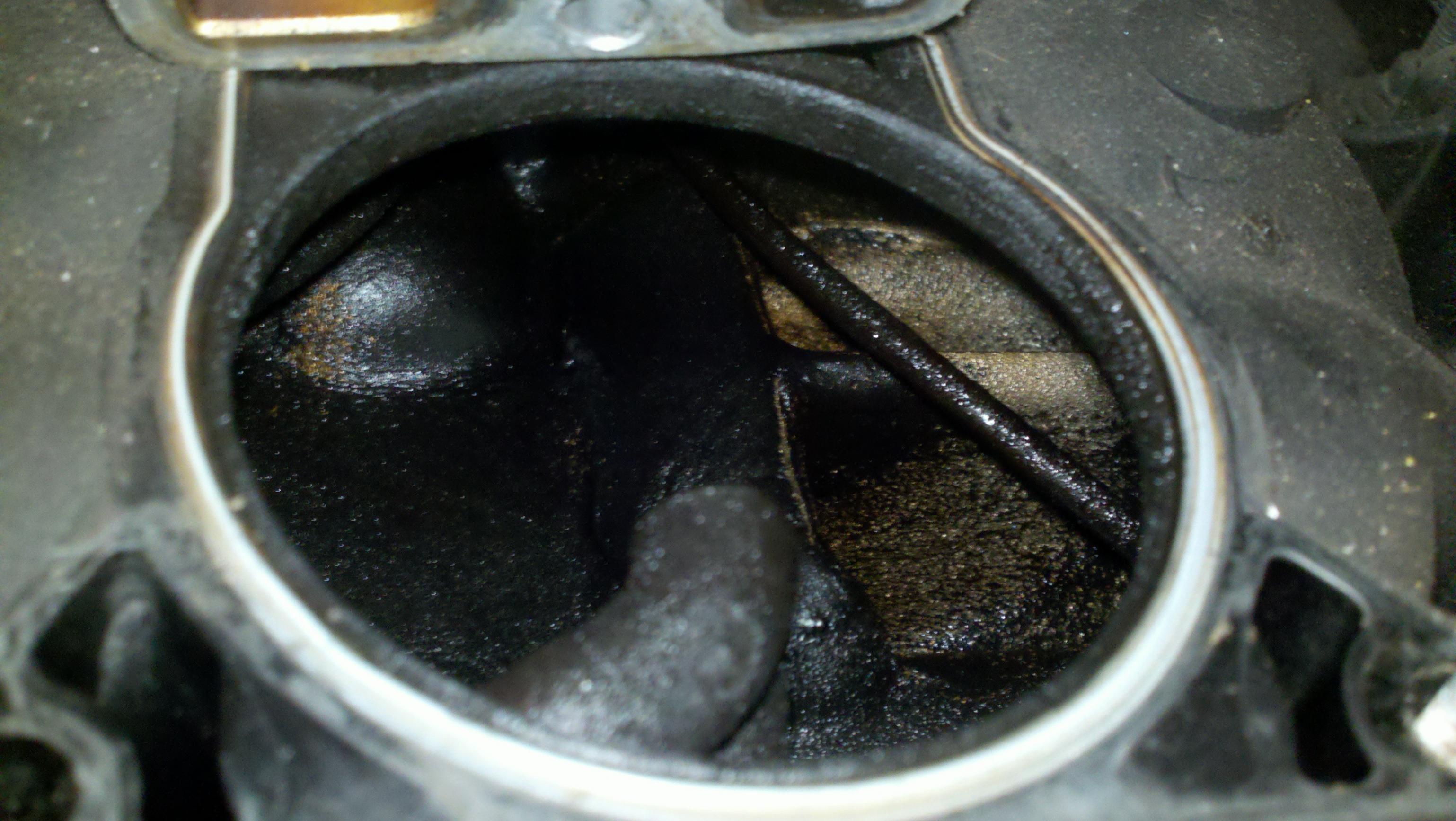

By the way, what do I do about this carbon that is in there? Leave it there or is there a cleaner for it?
https://blazerforum.com/forum/attach...-42-52_744-jpg

You notice power from the filter,not the spacer. but ewwww at the carbon. best thing you could do is spray some aresol seafoam in there,let it sit for a while and run the engine. Carbon in that area isnt a big deal. if you had clumps of it that'd be a different story.
