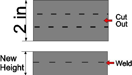

Ill have to measure to double check how thick they are now. even though id recommend you figure out exactly how much will work for you. I cut the center out of the height, however much i shortened em and welded the pieces back together. you will need new bolts when u do this, youll run out of threads. If you would have asked for pictures 1 day earlier, my front end was still torn down. I put my mad graphic design skills to work for you though...lol

lol, thanks for the image! That looks pretty straight forward. Granted I can't weld and would have to get somebody to weld that for me, doesn't look too bad. Just wish it would work as is. Nothing is ever easy these days is it?
