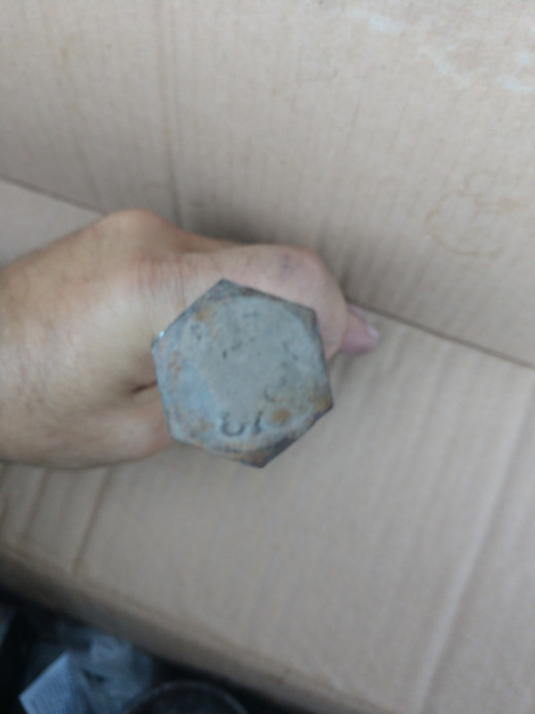

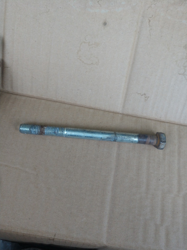

Old Aug 16, 2019 | 01:40 PM
Hess13x's Avatar
Joined: Dec 2018
Posts: 697
From: Idaho
I have a bolt from my 2" body lift in my truck. I'll measure it when I go to lunch.
Old Aug 16, 2019 | 02:03 PM
Hess13x's Avatar
Joined: Dec 2018
Posts: 697
From: Idaho
12mm x 140mm that is for a 2" body lift
Old Aug 16, 2019 | 02:17 PM
Cimmerian's Avatar
Joined: May 2018
Posts: 377
From: New Mexico
Thanks man, I really appreciate that. Can you take a couple pictures of it?
Old Aug 16, 2019 | 02:26 PM
Hess13x's Avatar
Joined: Dec 2018
Posts: 697
From: Idaho
Yup give just a few
Old Aug 16, 2019 | 03:09 PM
Hess13x's Avatar
Joined: Dec 2018
Posts: 697
From: Idaho
Old Aug 16, 2019 | 04:50 PM
Cimmerian's Avatar
Joined: May 2018
Posts: 377
From: New Mexico
Thank you my good man, you are a life saver.
Old Aug 16, 2019 | 05:12 PM
Hess13x's Avatar
Joined: Dec 2018
Posts: 697
From: Idaho
Not a problem, glad I could help. I'm building a 3" body lift to replace my 2". I need to check but I think I can reuse the bolts from the 2" kit.
