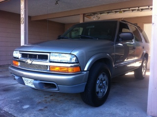

the previous owner of this blazer must have tightened it. i havent tightened them at all myself and there already maxed out. as for the front end it isnt any high than what i would imagine stock height is

Torsion bars wear out. Check junk yards for a set of low mileage bars, bars from a zr2, or buy lift keys off eBay. I must say the underside of that thing looks immaculate.

Looks to me like you have worn/saggy torsion bars. Best bet is like Sickman said and try to find some replacement bars. If you decide to replace the torsion bars, this info might help a little:
