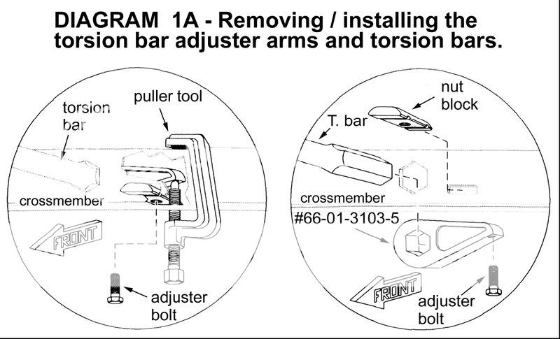

It is not just a puller. There are actually two different loading/unloading tool styles you can get. One looks like a beefy C-Clamp:
And the others look like this:
the top one is a designated GM only part. The bottomtwo arerated to also work on Ford trucks.
Using a two jaw puller will do nothing more than damage your corssmember. You can use a C-clamp but it isnt very safe.

no pic on tool #2.
And how does the beefy c clamp help...dont you have to actually twist the bar to pre-load? Or what is involved?

Here ya go... this should explain.....
You must first compress/load the barwith the beefy c-clamp thing. Then you remove the adjuster bolt/block. You then carefully unload the bar by unscrewing said torsion tool. To re-install you reverse that process...

That sure would have made it easier..
