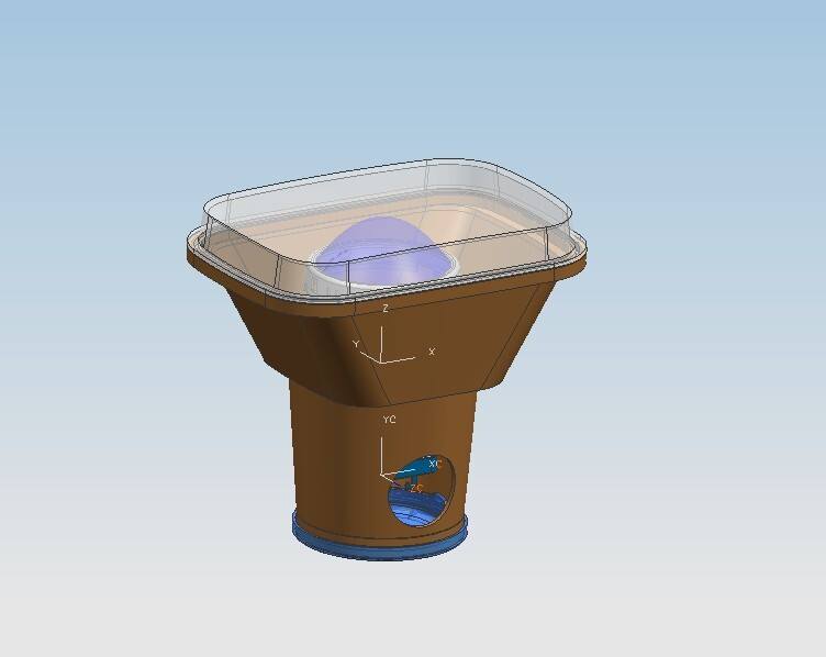

TRS is working on a 6x7 sealed housing with HID projectors. Not sure if they will be a direct fit or not, as the battery area can be tight. For a simple hopefully bolt in upgrade, these will be the way to go.
