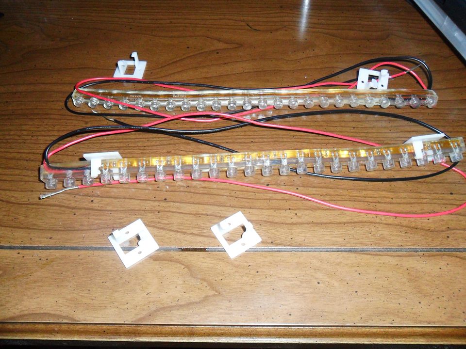

According to this thread I'll be wiring them from the front..... No problem though. A few measurements and they should be done.
Heres a picture of em! The clips are not exactly what i expected for something that claimed to be waterproof... Only about a foot in length too. But that's okay!
Attached Thumbnails Adding a set of LED blinkers-1002438_687122631314072_1849396708_n.jpg
