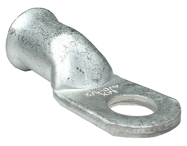

I just got a couple of these in a 2/0(i put two 1/0 wires in it) wire size, with a 3/8 hole. I don't use the red/black terminal covers anyway.

isnt 1/0 bigger that 2/0? Typo maybe? Anyway thats what I used and I used a large flat head screw driver and a hammer to crimp it on the wire

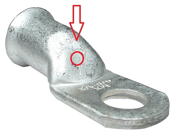

When I use those terminals I will normally drill a small hole in the top and solder the wire in, a small butane torch will normally get it hot enough than feed the solder in through the hole, a trick my dad taught me from when he was in the navy. I don't trust crimping for some reason, I prefer to solder if at all possible.

Good call on drilling the hole Swells. I am just going to crimp them and shrink wrap them since we have all the equipment at work.
