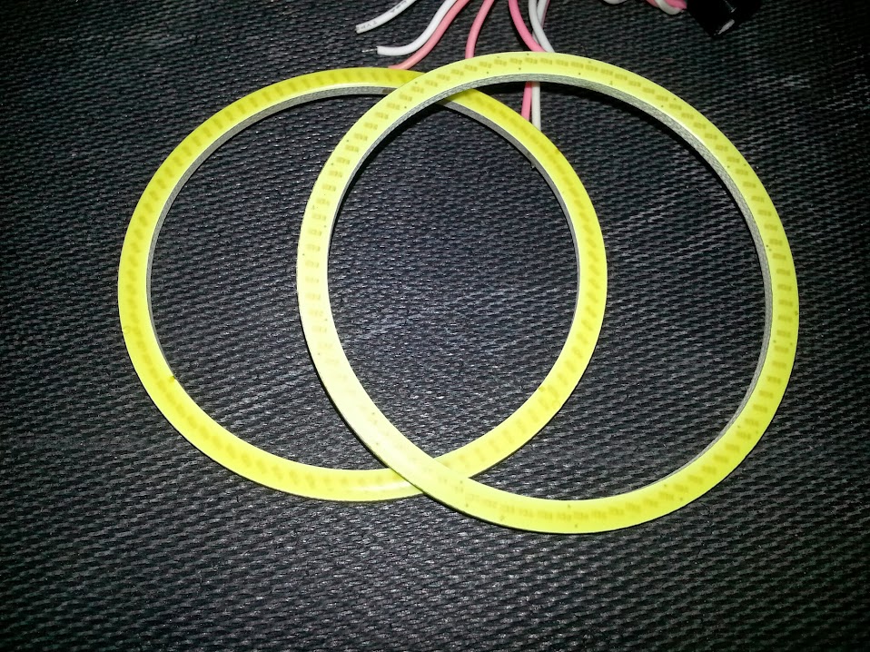

At any rate, guess what the maillady brought!!! 70mm x 80mm 5000k white halos.

I think the LED halos may be a little bright, I could see the circular shape burned into my retinas for 10 mins after testing them.

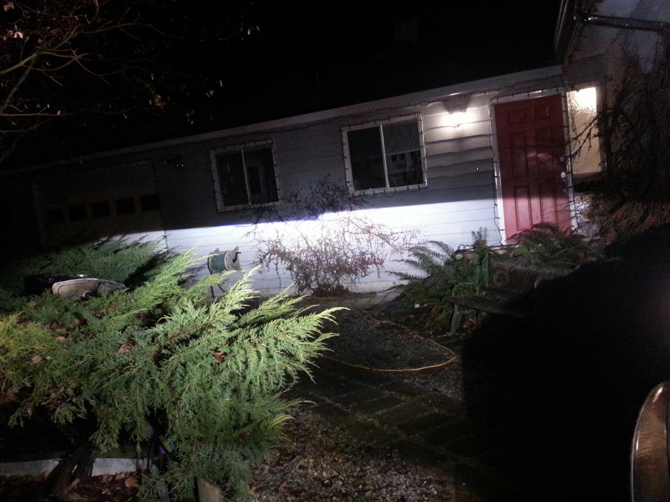

Give us some output shots of the projectors. I know TRS has some shots, but I want to know how to perform right out of the box.
I'm SUPER excited to see this finished, by the way!

This picture is less than a minute after putting power to it for the first time. It really doesn't do it justice!! Right in the middle it has the blue flare that I've read about. As a reference, the porch light is a 60W soft white fluorescent bulb.
