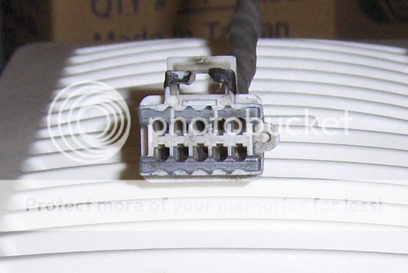

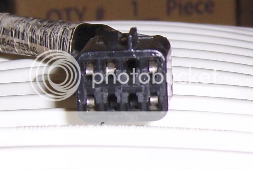

but the plug is totally different. i'm going to upload a couple of pic's to PB to show you.........................
ok....i'm back finally. (as you can see, PB was being a bitch tonight for some reason.)
so, here's what the 2000 plug looks like (this is looking @ the wire side of the plug, from the mirror side).......
and this is the plug that was on my trucks original mirrors......
as you can see, there is 2 more holes in the newer plug. but both style of mirrors have the same amount of wires (5) and use the same coloured wires for each side. meaning the 3 coloured wires & 2 black wires used on the 2000 left mirror, are the same that is used on the 1998 left mirror.
i just used a terminal removal tool to pull out all of the wires from the plug body, and reinstalled the wires in the correct style plug for the truck.

like i said earlier, the 2000 has a 10-pin connector (1st pic).
not 100% sure about your '97, but my '98 has the 8-pin connector (2nd pic).
