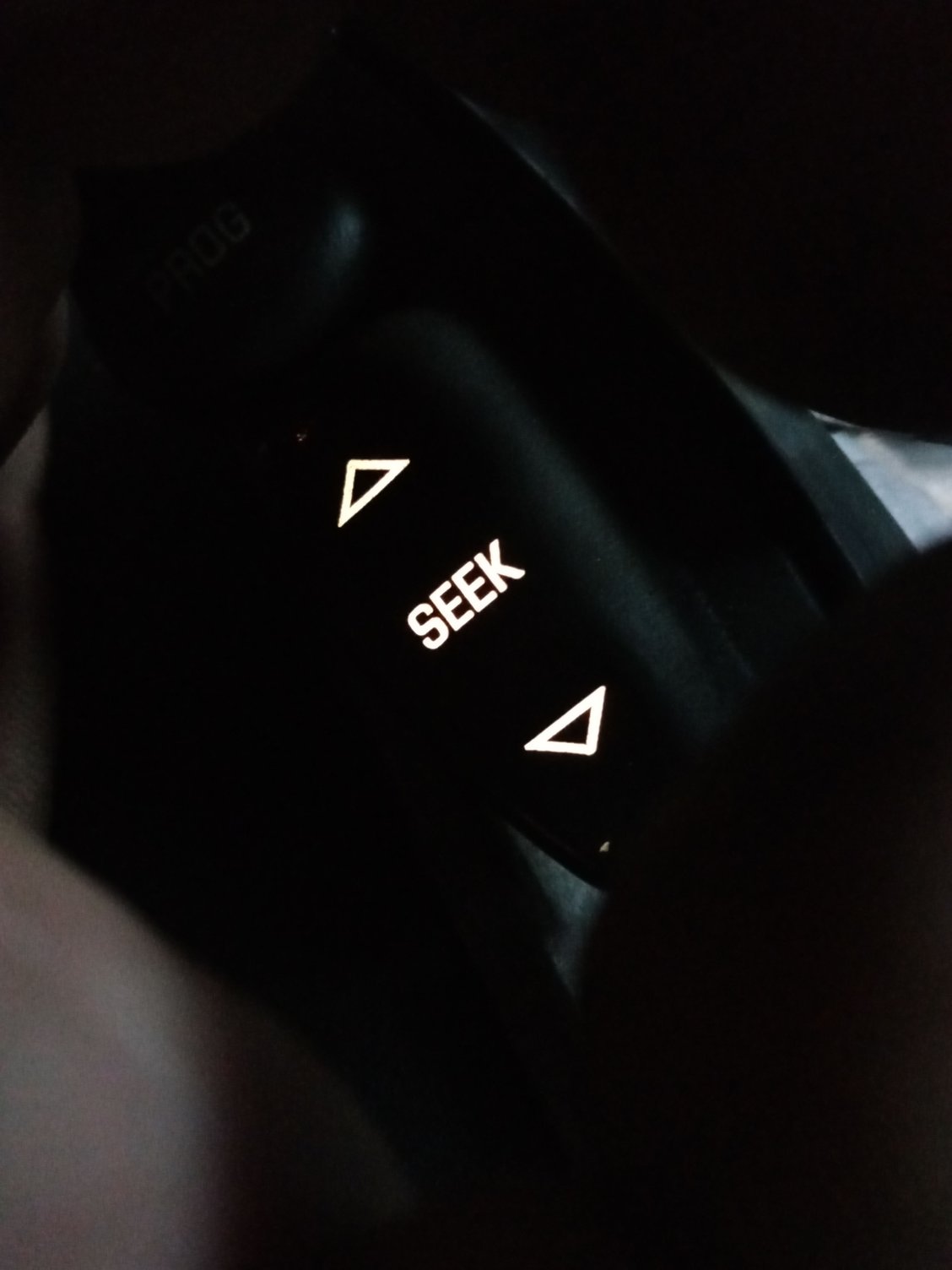

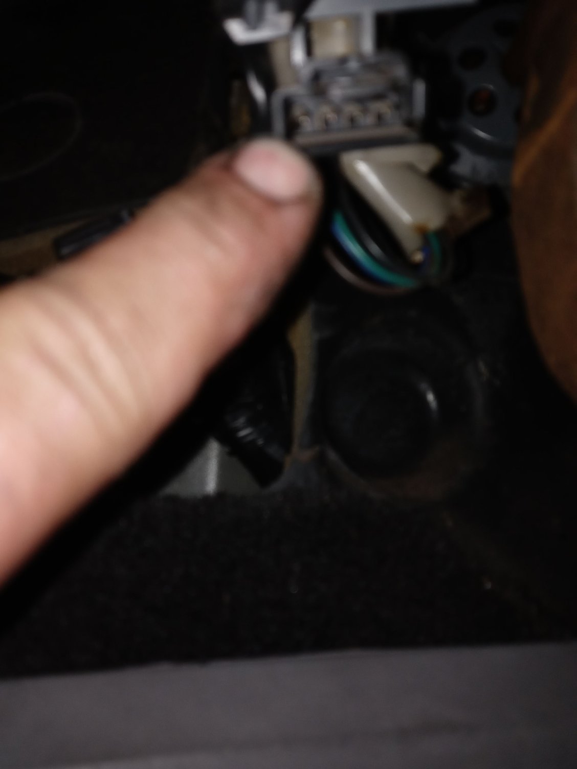

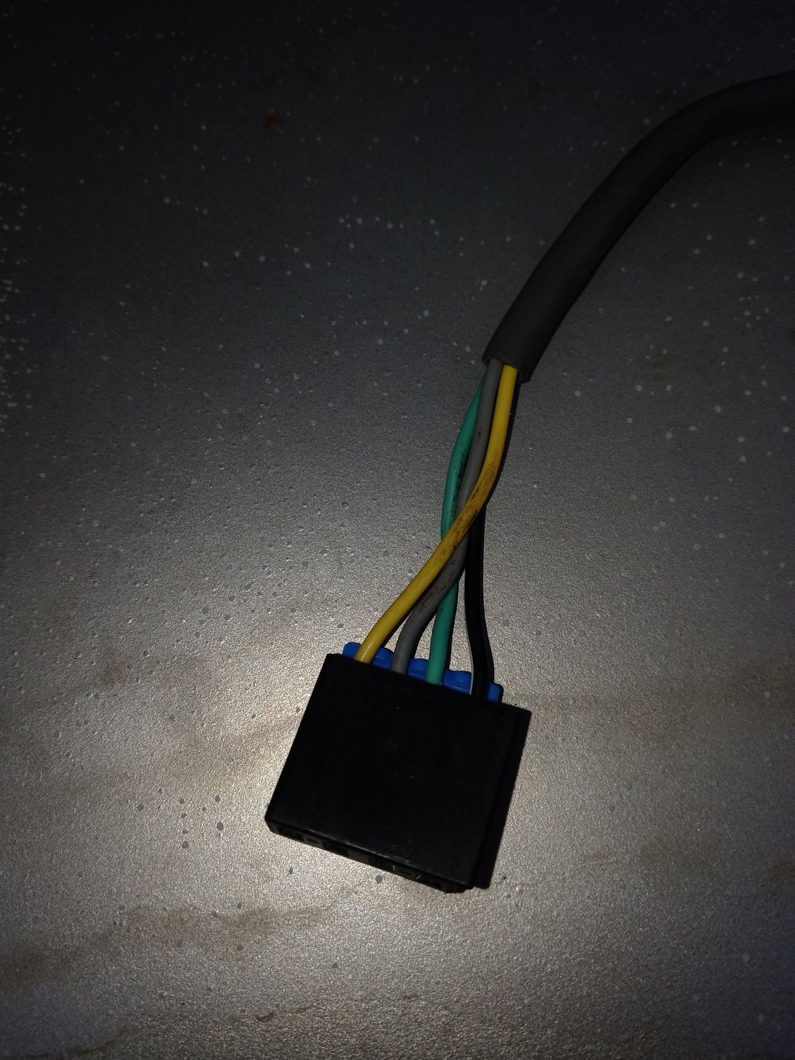

Saw some questions if the 00-05 supported the wheel controls. The answer is yes. Pics attatched are components pulled from a 01 Jimmy and proper clock spring w numbers location of connector for power and lighting. This is plug and play other than behind wheel trim the rear airbag cover supports buttons to prevent breaking. All parts were s10/blazer/Jimmy parts, wiring colors change at bottom of column from yellow green brown and black to blue black brown and Grey and are supported all the way to radio connector. There is zero cutting splicing solder crimp or modifications. If your blazer had steering wheel illumination fuse 2amp last fuse top rh side the wiring exists.
controls, location of main connector bottom of main ignition break out. Clock spring and illuminated
