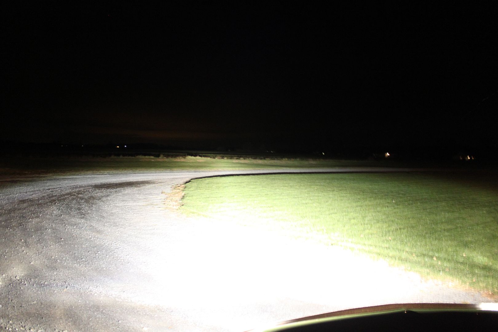

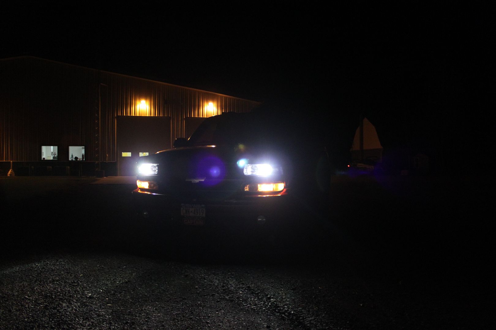

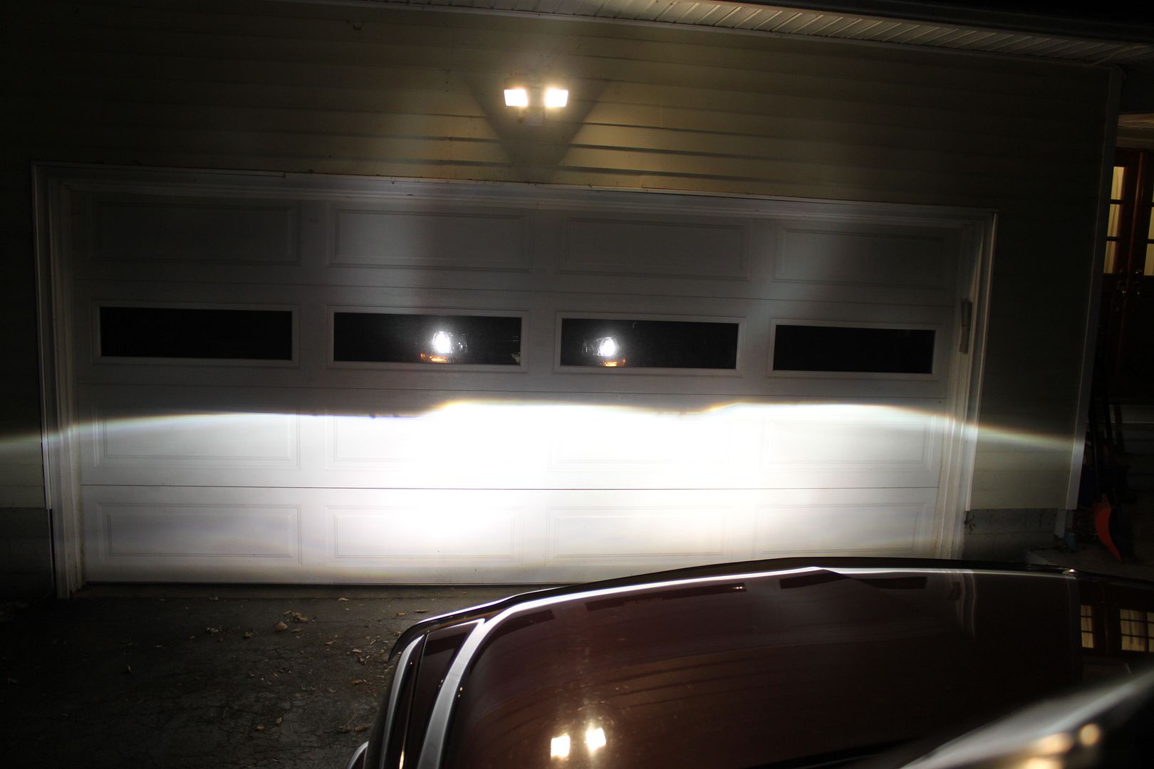

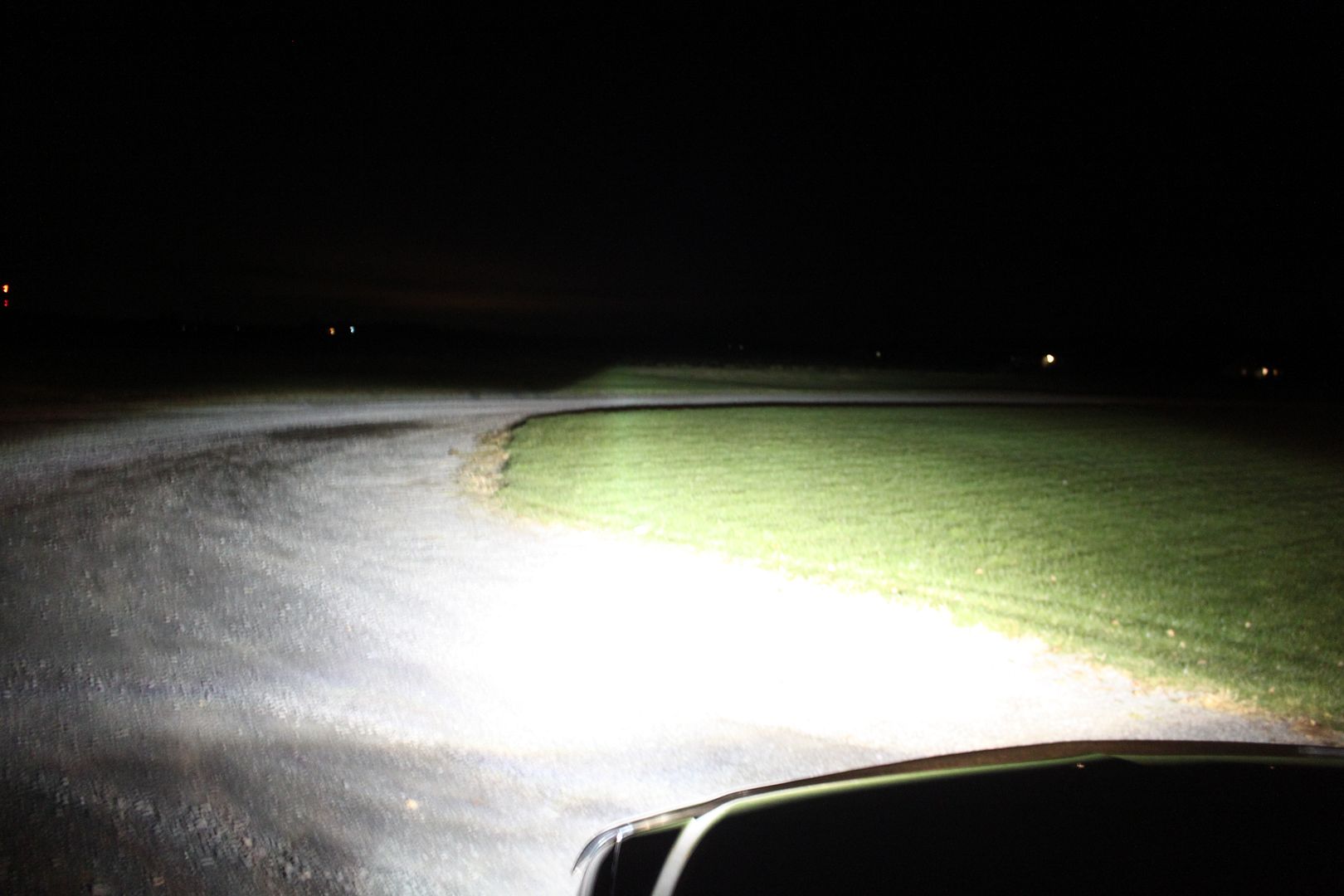

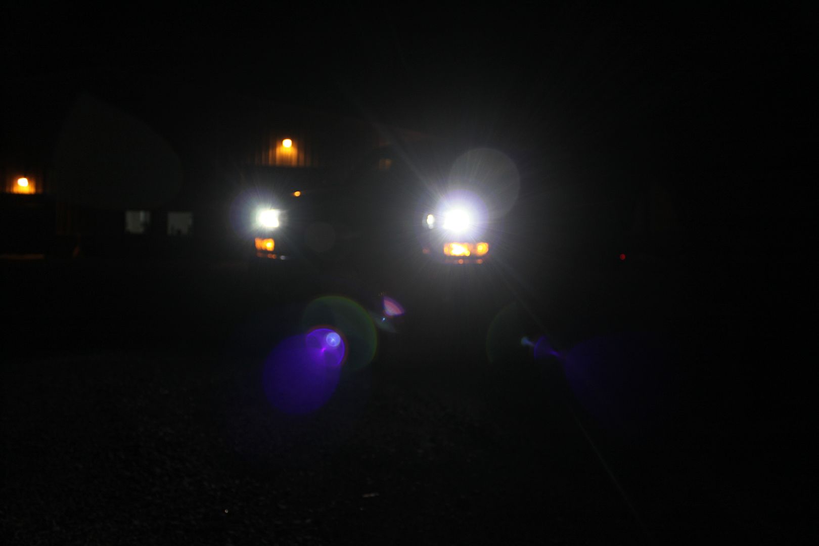

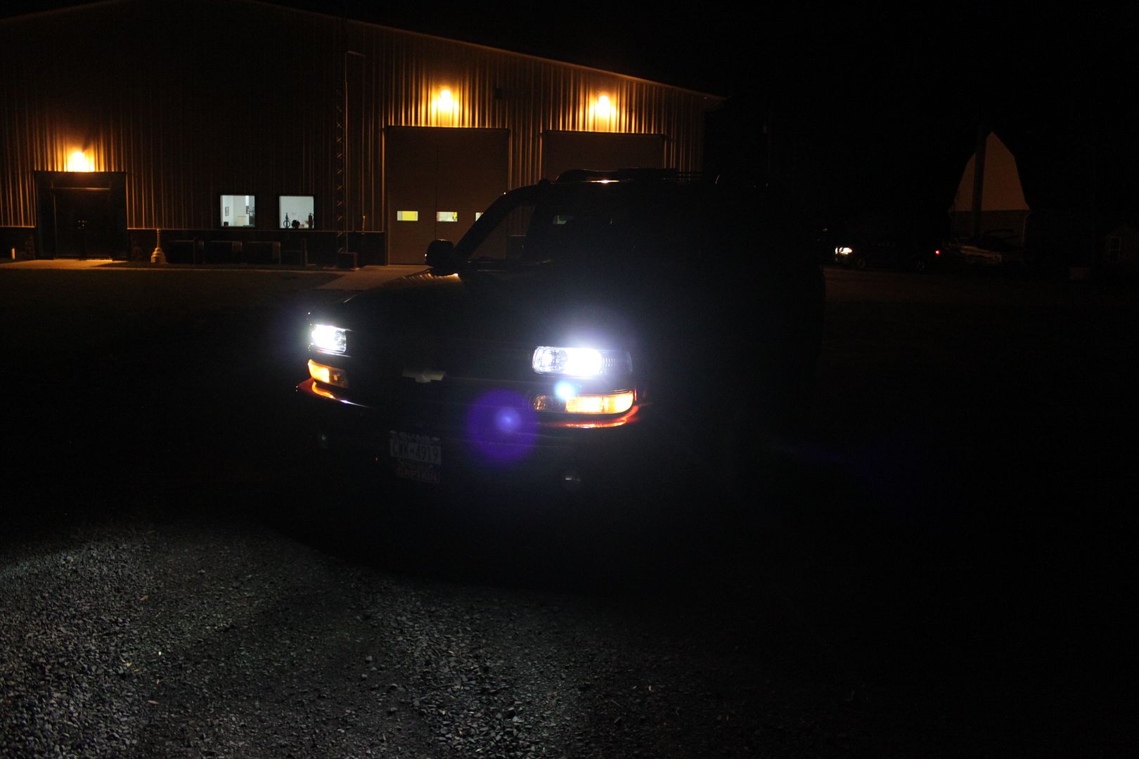

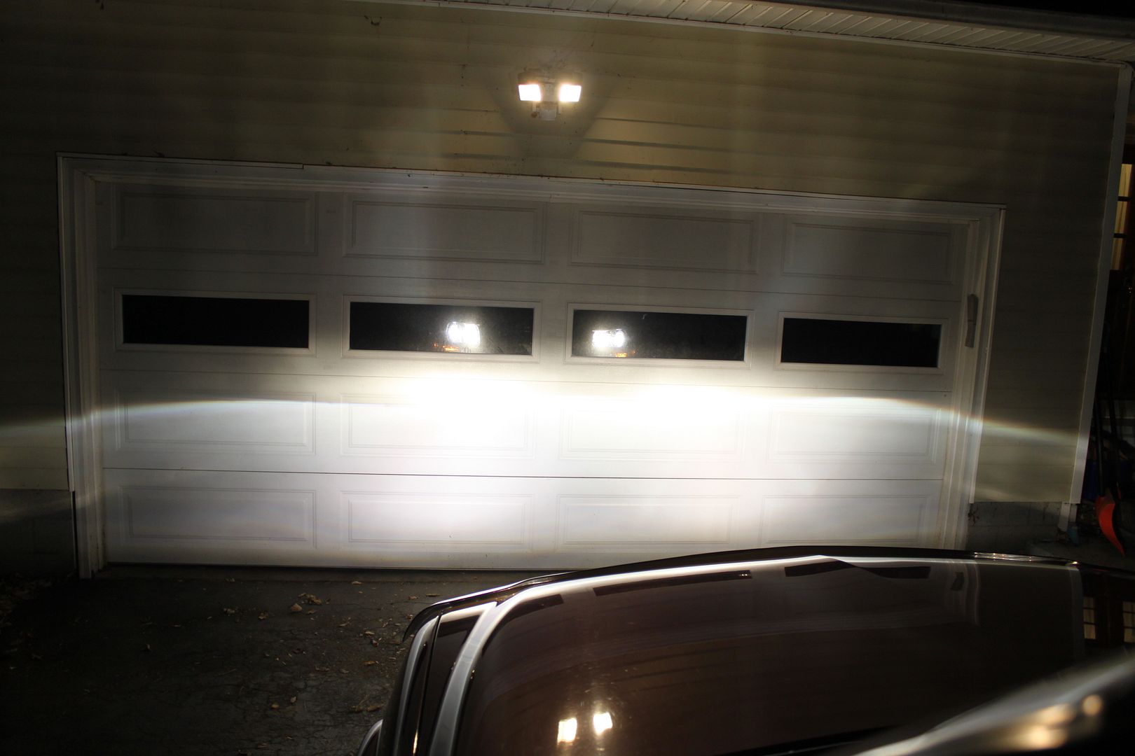

Impressions after a good alignment and some night driving... OMG! The beam pattern for both low beams w/ 5000k 55w HID and highs with Phillips HIR 9011 bulbs is so much more full everywhere!!
While my cell phone takes pretty good daytime pics, I couldn't get good night shots. I'm going to toss the T1i into the truck tomorrow and see about some pics after our Turkey Party at the FD tomorrow night. Should be able to get some good pictures out back of the hall.
Old Nov 17, 2011 | 10:49 PM
  #23
Rottidog's Avatar
Joined: Sep 2008
Posts: 2,522
From: Winnipeg, Manitoba
lol yup, I swapped out my 8000K HID's in the projectors to 5000K - WOW!!
Those look really good Kyle, not quite stock, you kinda have to look for the projector lens. Night pics should be interesting.
Old Nov 18, 2011 | 09:47 PM
  #24
Posts: 41,336

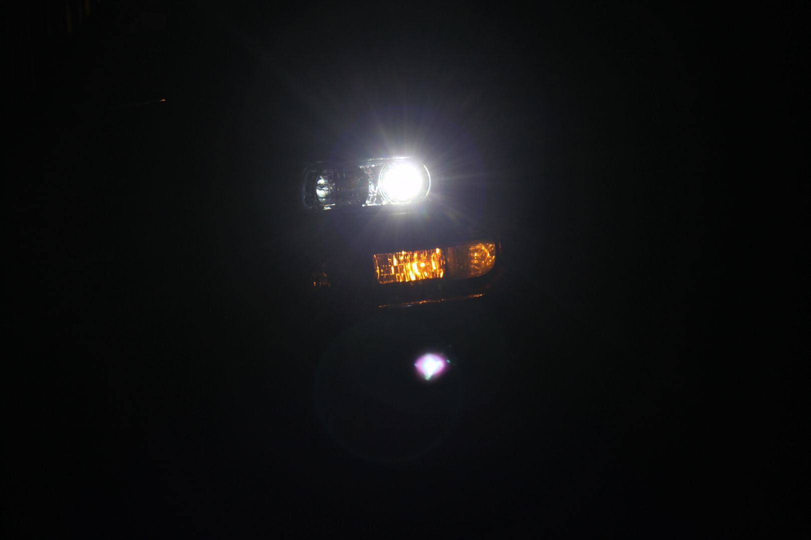

Night shots as promised!
Yeah, they look great IMO! I'm very happy with them.
The pictures show somewhat of a hotspot that isn't really detectable with the eye its so subtle.
Low Beams:
Quad - Highs & Lows:
Image details can be seen in the Photobucket Album.
