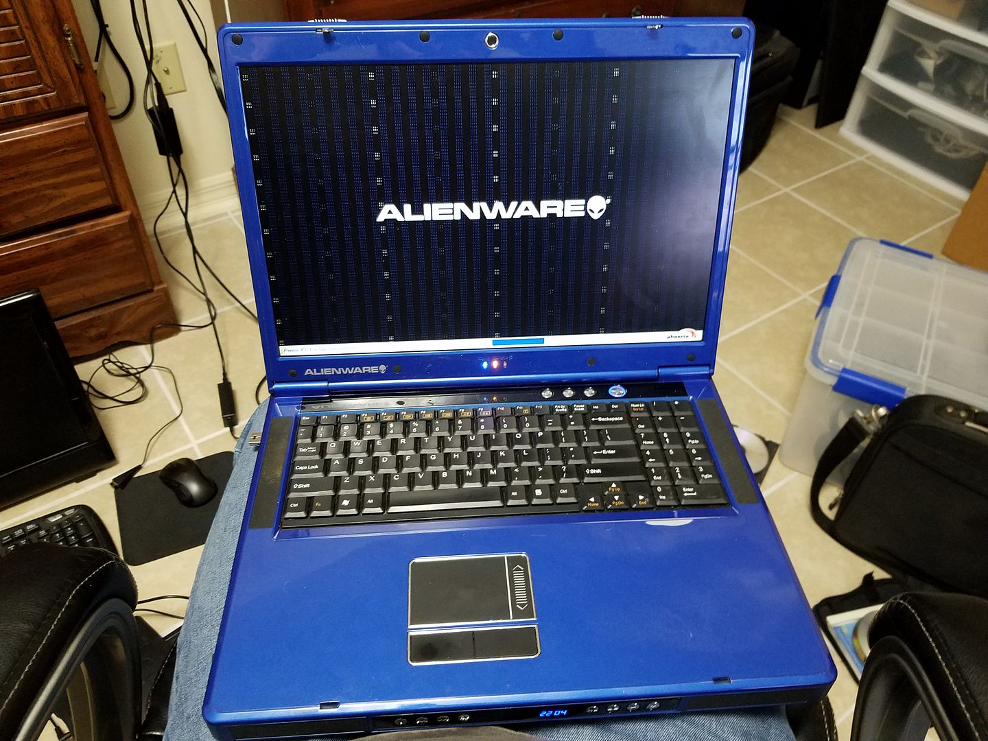

My new adventure has me playing with and possibly resto-modding an old Alienware Aurora M-7700 laptop
The thing is a MONSTER at 13lbs... AMD Athlon X64 X2 3000+, nVidia GeForce 6800 256mb discrete GPU, 512mb DDR RAM (yes, DDR, not DDR2, DDR3, etc), and currently no hard drive. Having issues with it recognizing SATA drives, from what I read it's a compatibility issue; HAVE to use SATA1.5 drives, the BIOS will not even recognize SATA3 drives... And it needs a screen as you can see... If I get it working well (with Windows 7), I plan on blowing it apart and giving it a nice custom paint job. Would be neat to slam this baby down on a table at work or school lol. Plus it's just nostalgic. When I got into building performance PC building, I could only DREAM of owning an Alien ware, much less something as powerful as one (at least that's what was in my head at the time). I acquired this one second hand for FREE, so I figured what the heck.
The thing is a MONSTER at 13lbs... AMD Athlon X64 X2 3000+, nVidia GeForce 6800 256mb discrete GPU, 512mb DDR RAM (yes, DDR, not DDR2, DDR3, etc), and currently no hard drive. Having issues with it recognizing SATA drives, from what I read it's a compatibility issue; HAVE to use SATA1.5 drives, the BIOS will not even recognize SATA3 drives... And it needs a screen as you can see... If I get it working well (with Windows 7), I plan on blowing it apart and giving it a nice custom paint job. Would be neat to slam this baby down on a table at work or school lol. Plus it's just nostalgic. When I got into building performance PC building, I could only DREAM of owning an Alien ware, much less something as powerful as one (at least that's what was in my head at the time). I acquired this one second hand for FREE, so I figured what the heck.Last edited by LesMyer; Feb 14, 2018 at 08:45 AM.

To follow up on the Alienware, I just so happened to have a pair of 80gb SATA 1.5 drives laying around in my stash
I popped them in and low and behold the bios seen them! I was able to RAID-0 them in the bios and install Windows 7 onto the system! Although it's a little sluggish, but I'm thinking that's because of the 512mb of RAM, LMAO! I though it was 1gb, but nope, not even... So I think I'm going to fall back to XP on it for now just to run some stress testing on it and make sure everything is up to snuff, and if it checks out I max the RAM out at it's limit of a whopping 4gb, and try Windows 7 on it again and see how it works out then.
