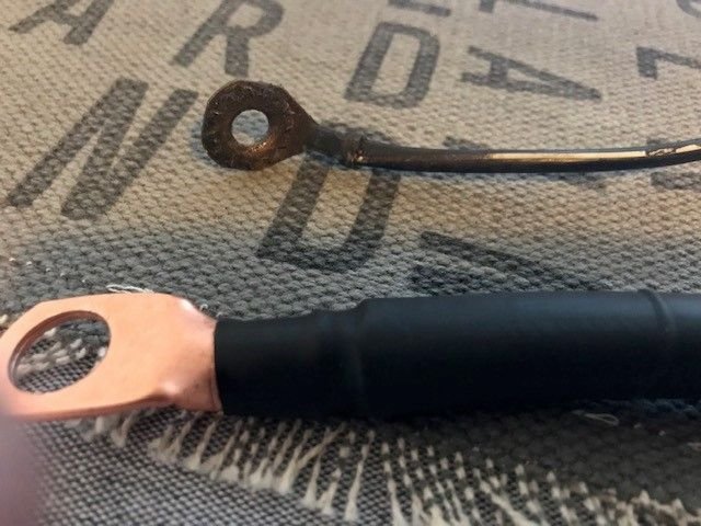

You will need 1/0Awg wire (welding cable is strong and cheap) A hammer lug And lugs that fit the gauge of the wire, A hammer, A youtube video on how to use a hammer lug Top post battery clamps And a youtube video on how to install them If you get a different battery may i recommend a 78 series duel posting (top And side) CCA 800 battery Which you will need to remove the rad cap off to squeeze in the battery ( Yes that close of a fit) This is for that extra cold cranking power in winter And a whole extra cell of reserved power. If you do not have the mechanical background skill of doing a battery swap 2 or 3 times before hand You will need someone that has to understand the smaller connected wires to Or from the battery that also need to transfer to the clamps
