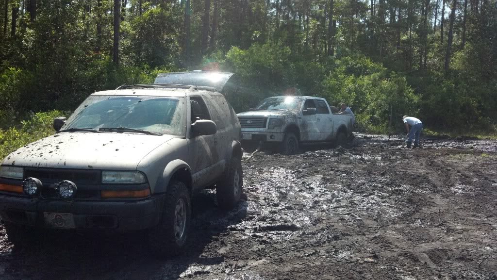

I don't run a winch, but I'd have no issues throwing one in any of my receivers if I had to. My response was mostly to the nonsense about not using receivers for recovery. I have a class 4 rear hitch with a shackle in it, and I bolted two class 4 receivers tubes into the tow hook/skid plate location which also have shackles. I've pulled out several full size trucks and have been pulled out by the same. Never a single issue, and it's as safe as any recovery point because I use proper equipment for my recoveries.
Just before my receiver, shackle and ARB strap dragged him out.

Read the line pull ratings and almost every front hitch made for any vehicle has that rating! A blazer is about 4000-4200lbs on the slow speed of a winch it should never have a problem and even stuck should it really never exceed 6500lbs. Ive seen many Heeps break this hitches from too much tongue weight, But never rip one off. To anyone who welds on a hitch from a junkyard and doesn't apply it correctly i could see why things are breaking. As for my rear hitch SnowBlaZeR2 i actually helped pull my buddies 5 ton deuce and a half on 53"s off the beach this past weekend. His front air line for the front axle had pulled off and i was pulling him while i had a ram 2500 with the hemi pulling me from my towhook only reason because he didnt have any other wise it would have been backwards. So he had his rear 2 sets of wheels but had to go backwards having more traction that way and was digging in the sand and the truck would just hop a little trying to find traction and just sink. With our 2 trucks hooked up and under his own power we were able to pull him off still slightly hopping taking over a good 5 mins. Also the truck weighed just over 20,000lbs. He had to have it weighted for registration purposed and i had someone pulling from the front of me while i was pulling him and doubt people are putting that much stress on a bumper or hitch as i did at that moment
Your the only person i can actually say that this is a problem using a hitch. I cant see how a bumper would be any stronger, It mounts to the frame the same way using the 2 frame rails and the winch is placed into the middle of the bumper (weak point would be no different from a hitch)

Hell yeah man! Ive pulled out 30 something cars/trucks the winter before last year and the largest was a fullsize Coca Cola box truck. Now after last weekend helping pull my buddies deuce, That will definitely end up being the largest
