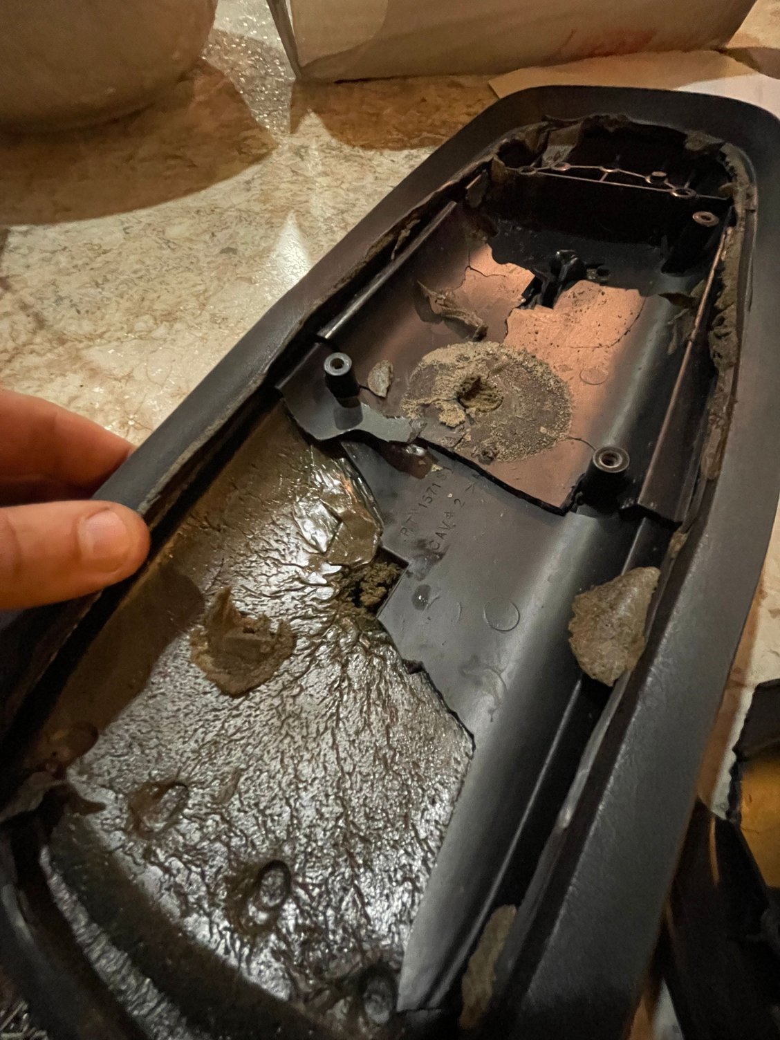

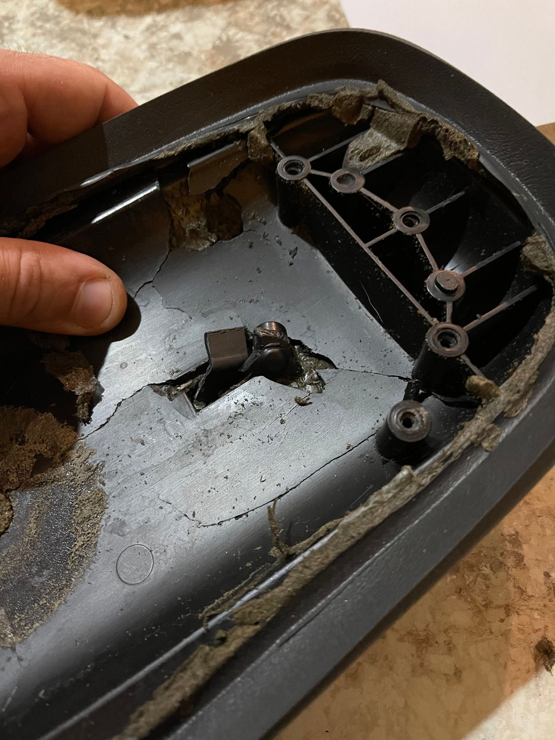

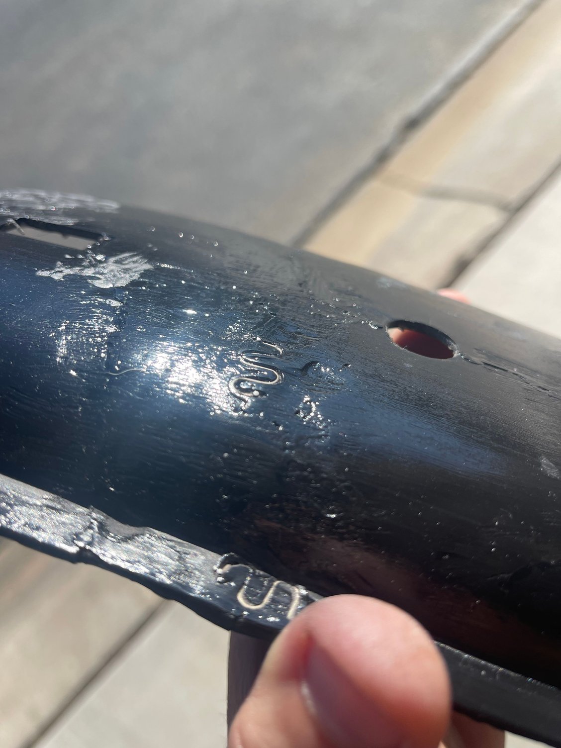

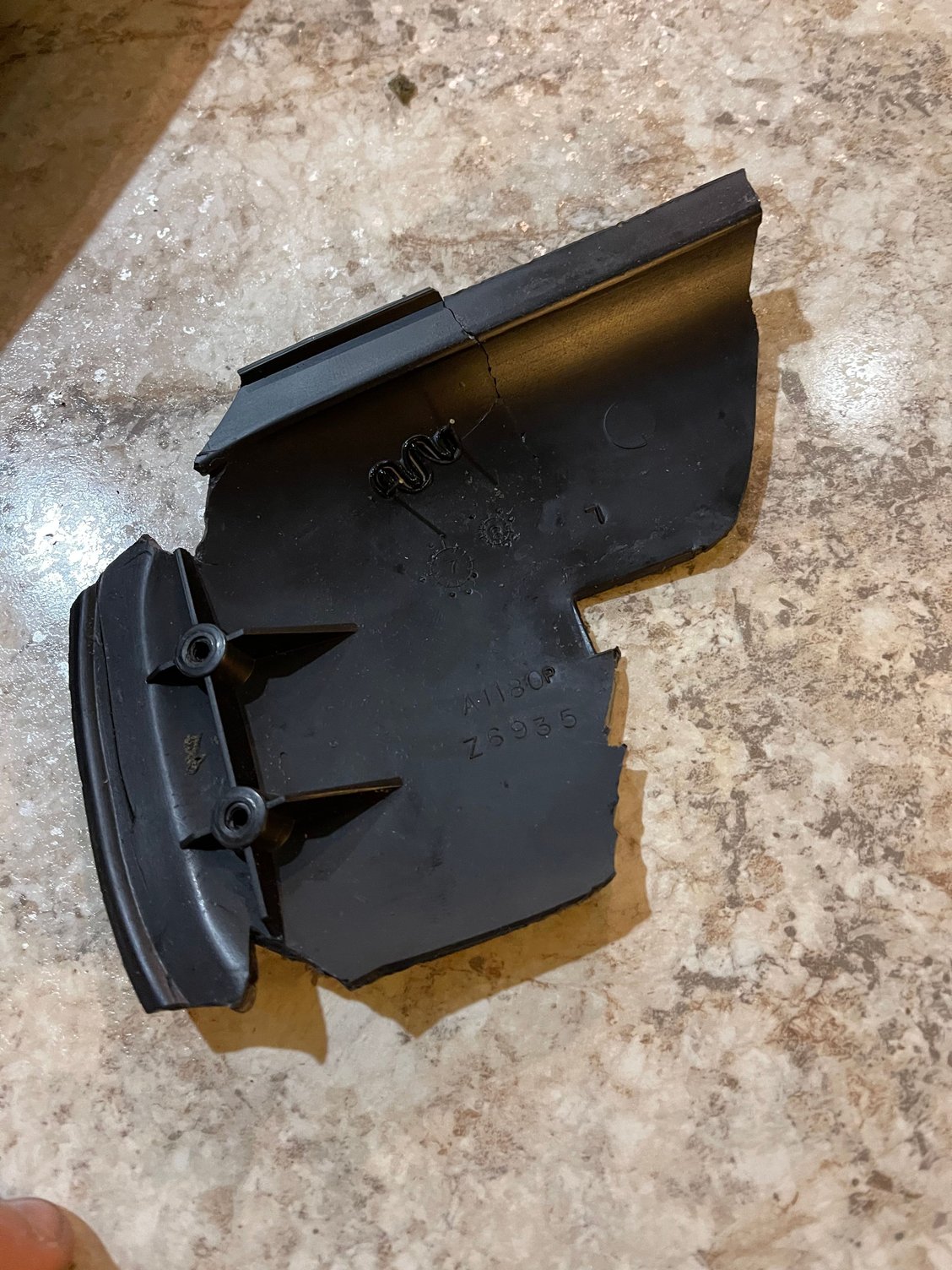

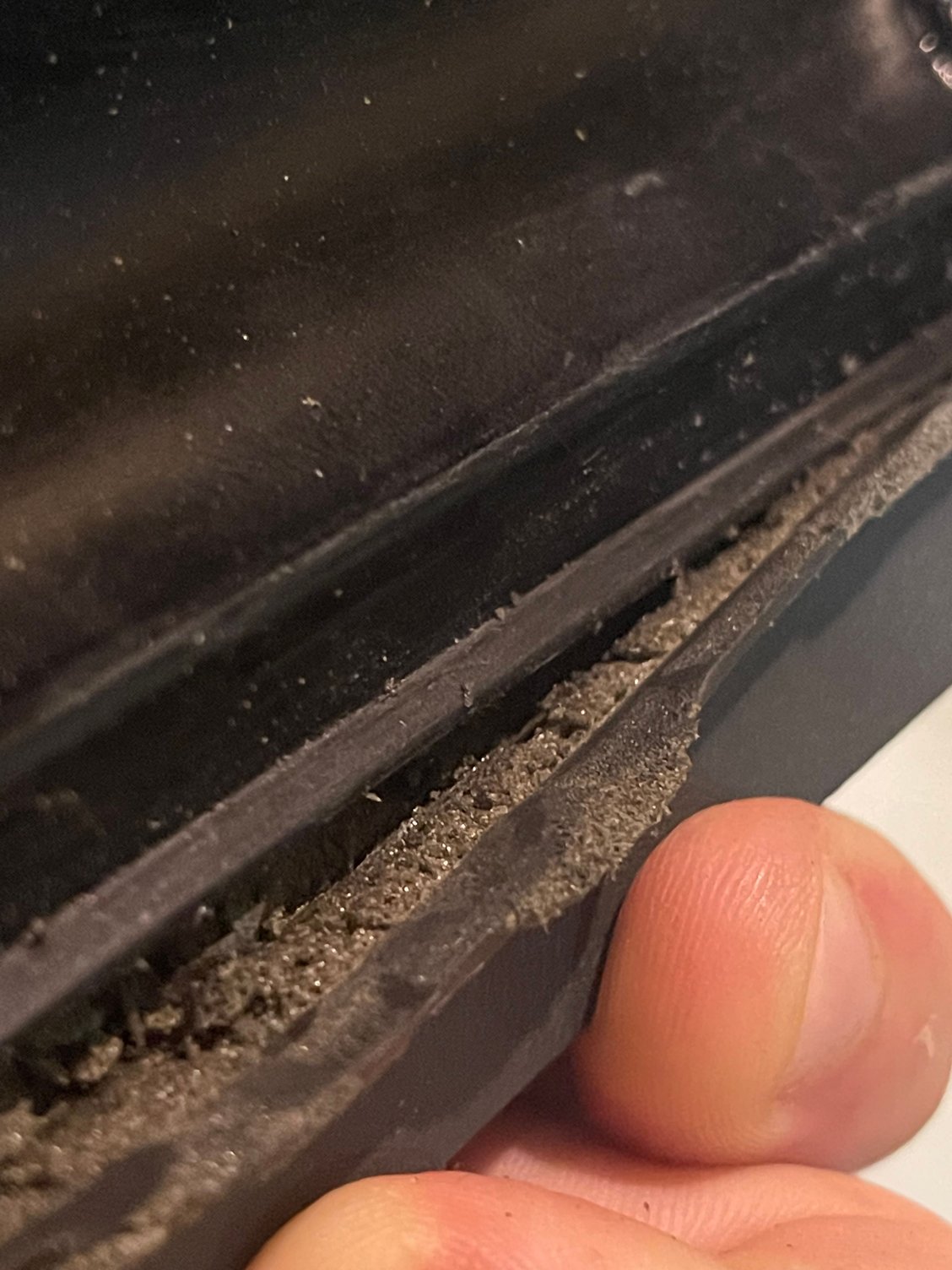

One of my most recent projects on the blazer has been repairing my center console lid. Dorman sells a full replacement for like $50 and you can get used on eBay for like $70-$80 with the same color of course but I didn’t want to have to get the vinyl dyed and I didn’t want to spend the extra money for a color matching replacement that potentially had the same issues so this was the course I chose, photos bellow:
Original condition
Original condition
Original condition

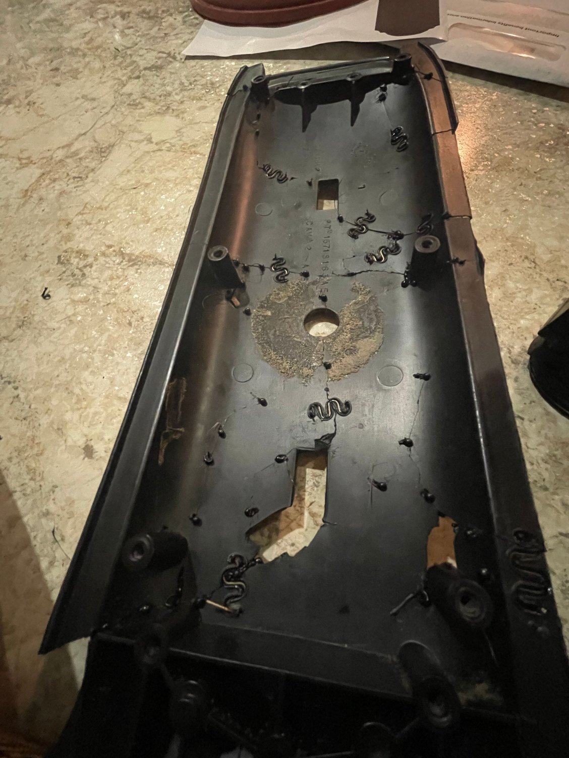

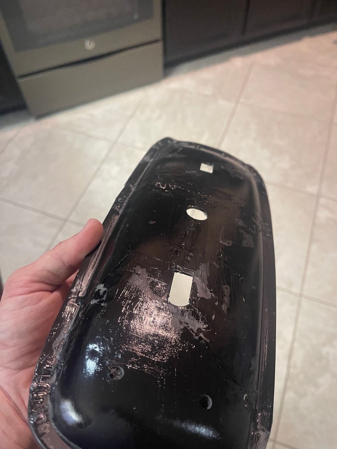

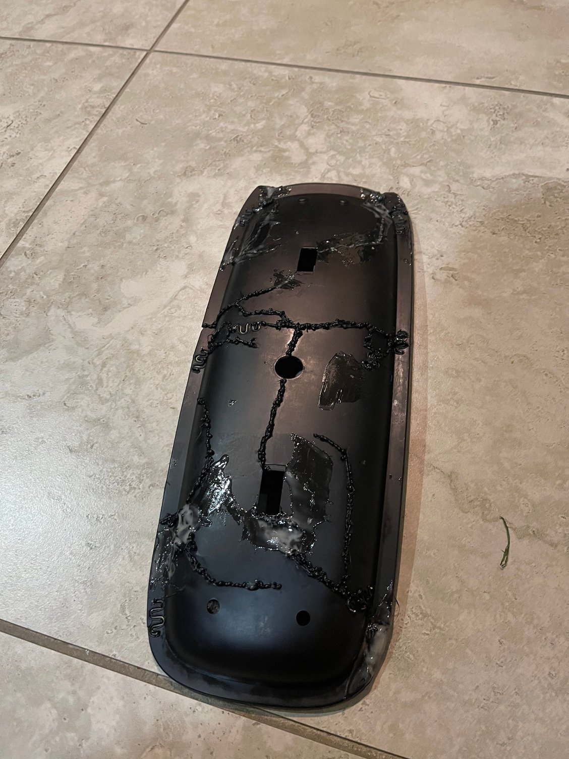

I used a 3D pen and some heated plastic welding staples to rebuild as much as possible and weld it together

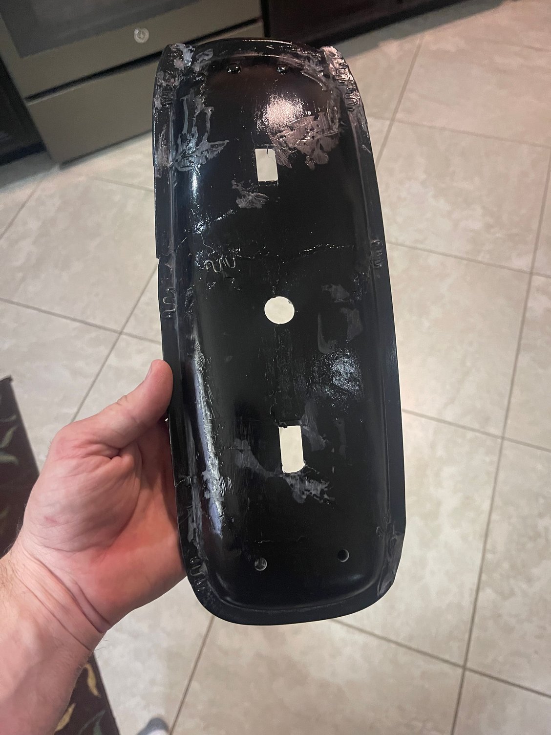

I then strengthened the weak cracks with JB weld plastic

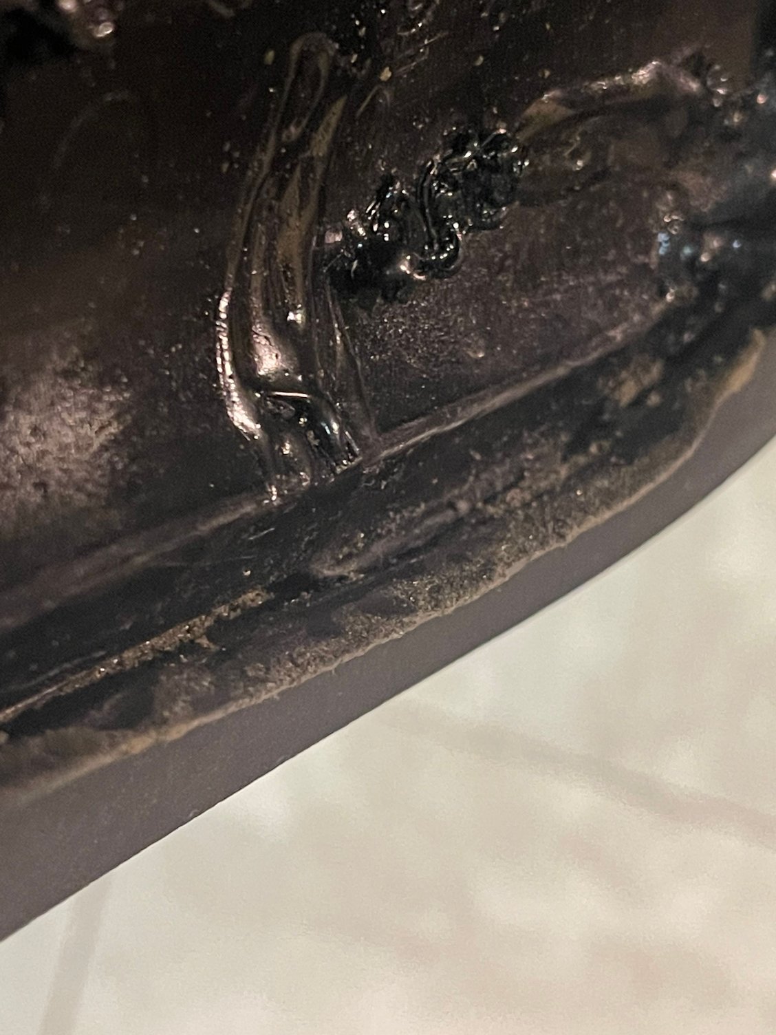

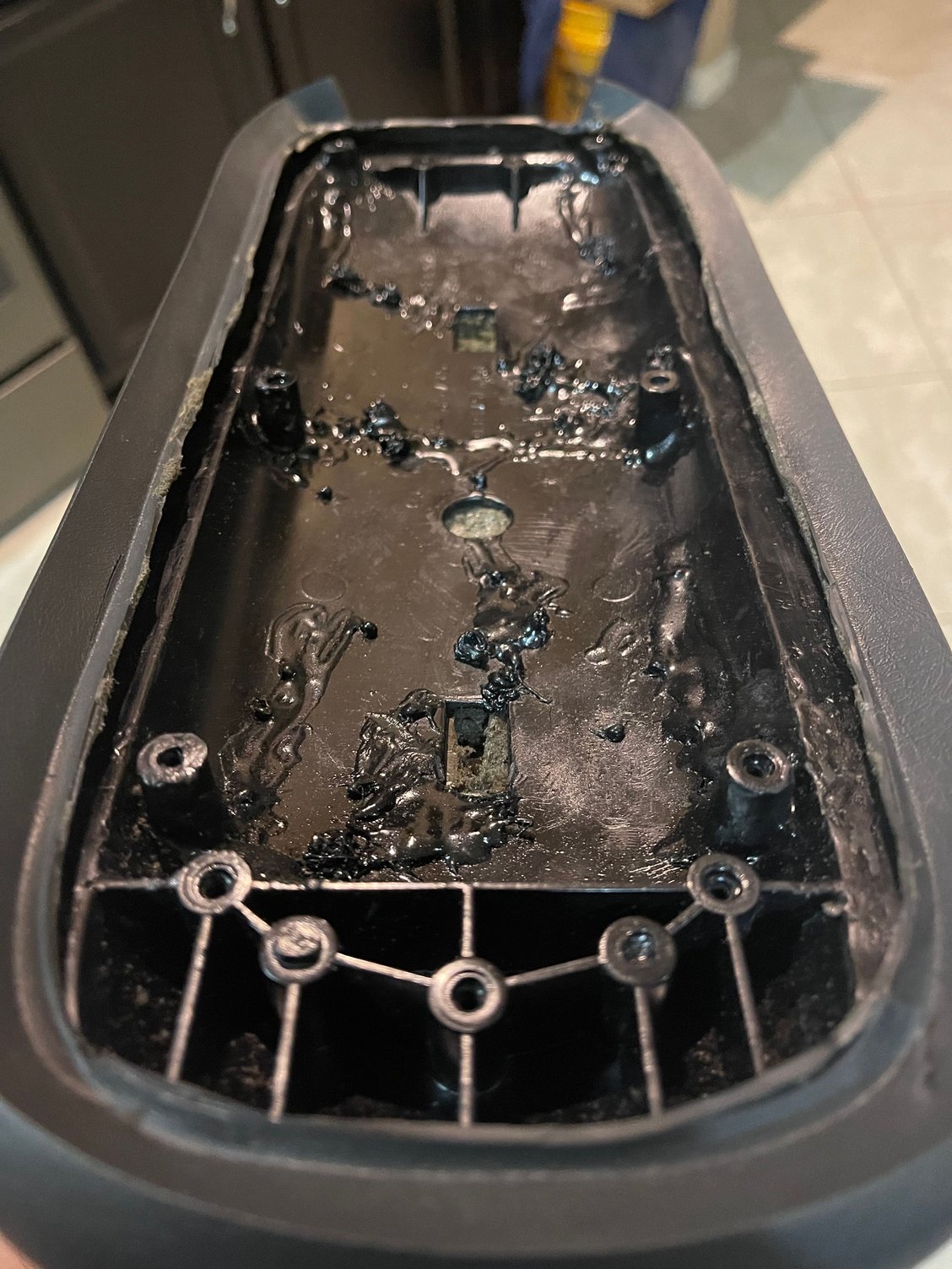

I then used a dremel and hand sanded any high points or sharp ends from the heated staples to get a nice smooth surface so it slides in easily to the padded vinyl. I went back over it lightly with jb weld to further smooth it
Next step is fitting it back in so I’m going to attempt to use a heat gun to fit it on and e6000 to attach the vinyl back to the lid. Worst case scenarios I will cut it again and reweld it inside the padded vinyl.
Lastly I will be doing like christine_208 did and fill in the lid with ABS slurry to make it rock solid, more pics to come!

my e6000 idea was an utter failure 😂 I’m about to mix up some slurry right now and fill it in but I’m still at a loss as to how to attach the pvc to the abs (vinyl to plastic) so any suggestions are welcome!
I was able to finesse the cover on with the heat gun and a screwdriver with minimal tearing
The current problem
Old Jan 14, 2023 | 11:06 AM
In what way did the e6000 fail? No adhesion?
Perhaps spray adhesive or a contact cement might work?
