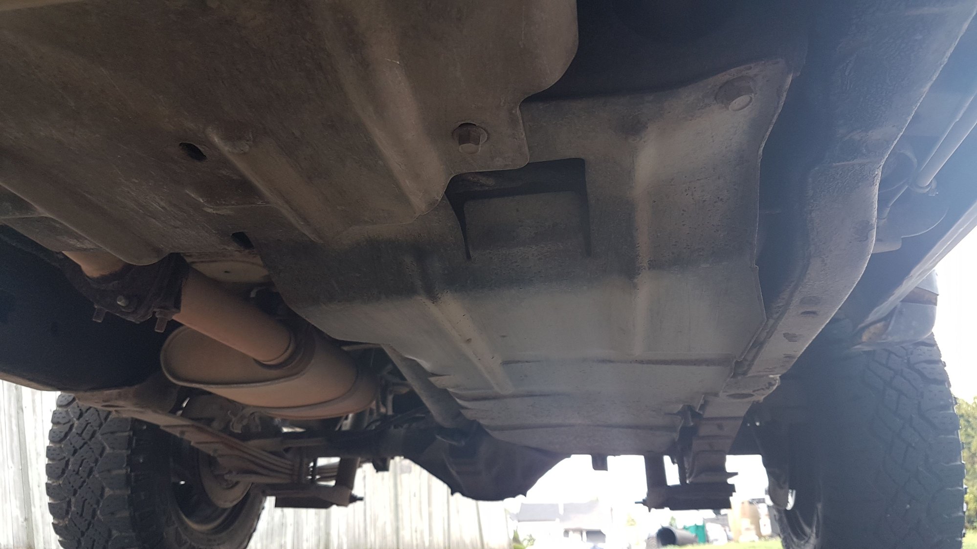

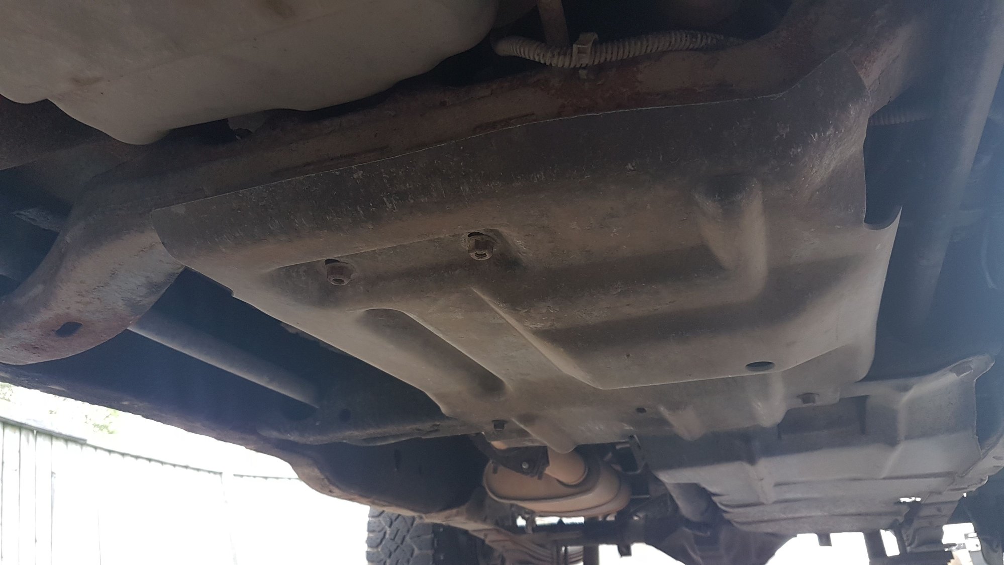

Old Aug 20, 2019 | 05:53 PM
  #53
Default Aluminum plates on 2.5 lifted 4 door
Aluminum non zr2 oil filter plate
Aluminum 3 button transfer case plate
Metal gas tank plate
Old Aug 20, 2019 | 06:35 PM
  #54
Cimmerian's Avatar
Joined: May 2018
Posts: 377
From: New Mexico
Damn. looks perfect. Makes me feel a lot better now.
