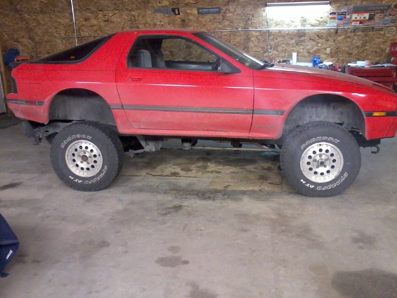

My morf is a 1986 RX7 with a narrowed and shortened GMC Jimmy S15 frame with a new center section installed and it's running gear.
I have over a year and thousands invested in project.
