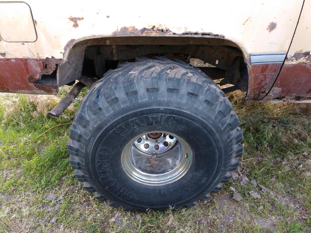

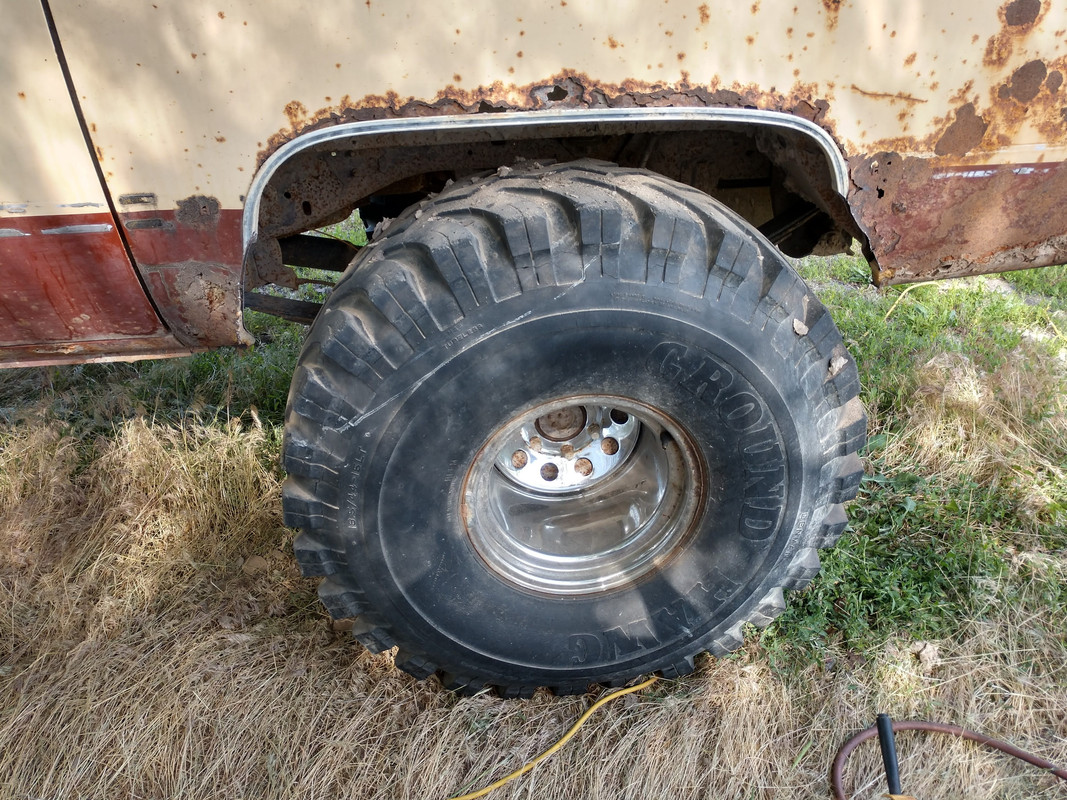

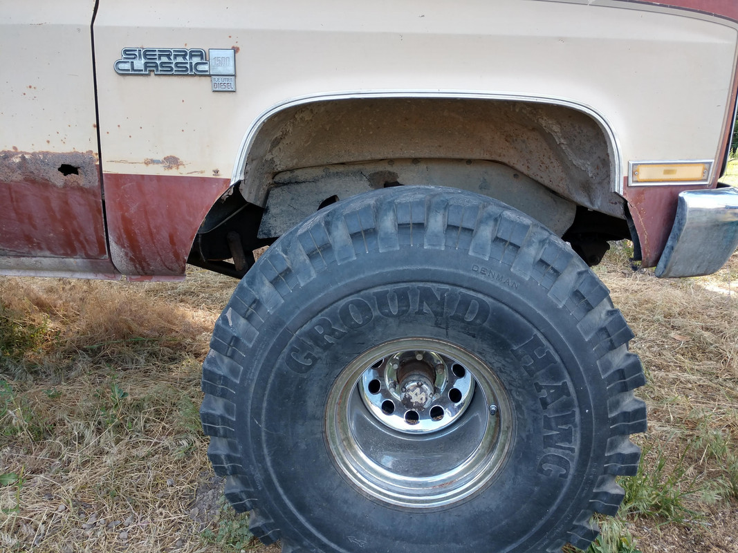

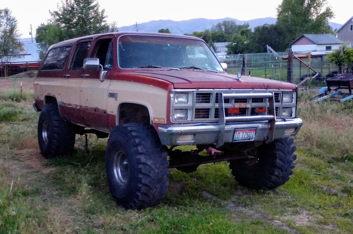

I have 44" tires on my 82 k10 suburban with a 6" lift and major trimming. It still rubs offroad. I'll find a pic.
Old May 9, 2020 | 12:11 AM
Hess13x's Avatar
Joined: Dec 2018
Posts: 697
From: Idaho
Before trimming.
What I had to cut.
So you can make 40s fit with 6" lift. I'm going to add a 3" body lift if I don't tear it down to use the drive train in my Jimmy or another project.
