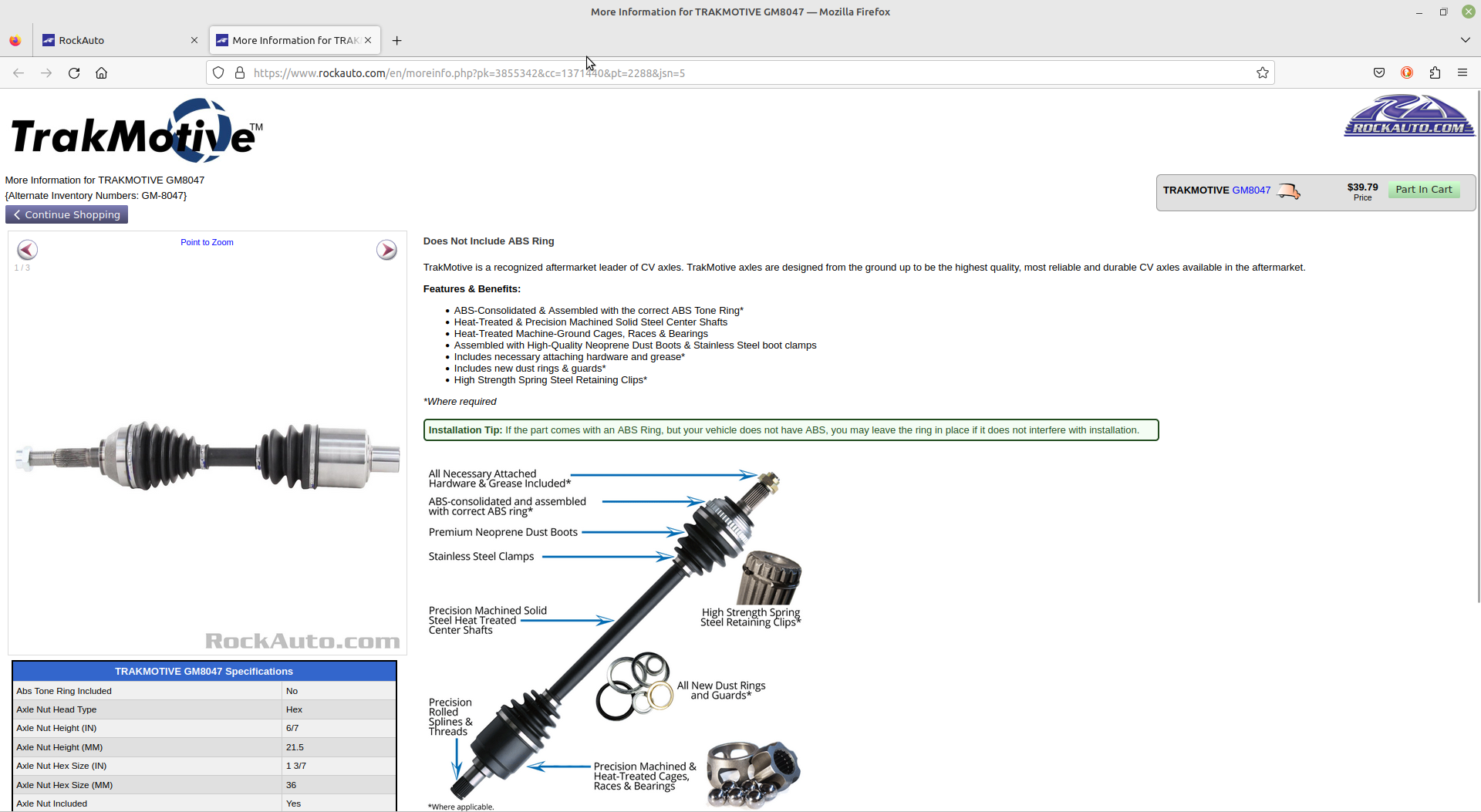

I used a cheapie from Rock Auto but it was right front. See attached. I found it to be just fine for my application (which is not a lifted vehicle). Your experience may vary on a lifted Blazer. Specs are attached, Driver's side is same price.

Thanks Les! I have done a decent amount of research on the aftermarket axles for a lifted application, and it seems the results really do vary. After not finding anything else wrong yesterday, I'm going to try a Cardone axle out, will post back here how it works out.
