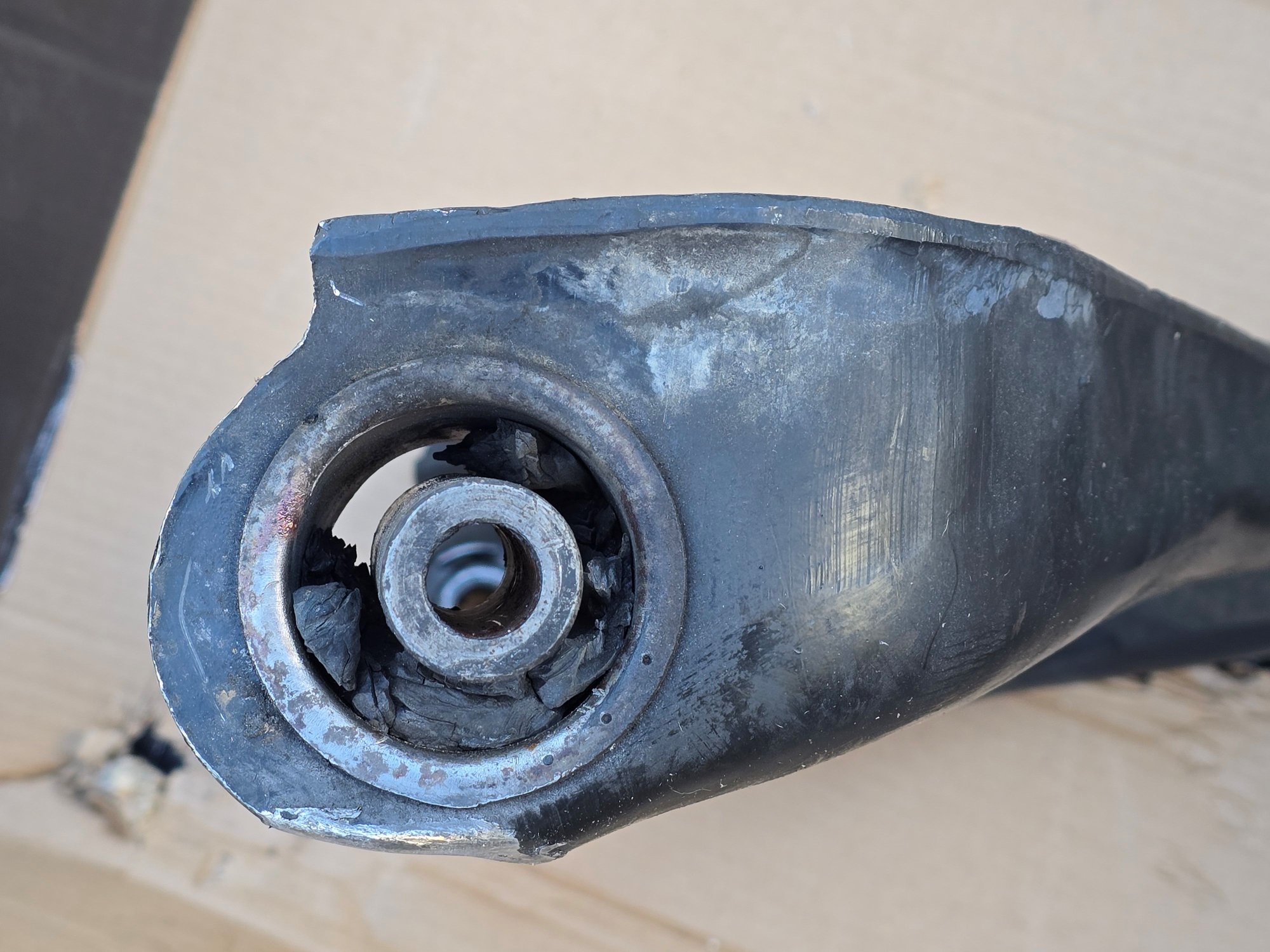

My buddy and I just spent 2+ days rebuilding the front end of my 2000 Jimmy 4x4. We didn't have a lift, so everything was done with the truck up on jackstands, except for the pitman arm, which I had my shop install. Every single front suspension or steering part with either a bushing or ball joint was replaced with a new Mevotech Supreme part from Rock Auto. The ball joints on the tie rods weren't too bad, but all the control arm ball joints were completely shot, and here's a pic of one of the bushings in the old passenger side LCA, which was the worst.

As you can imagine after seeing the condition of that LCA bushing, the reduction in steering play was dramatic. Prior to the rebuild, the play had become so bad that it was more like herding the truck down the road than steering it. I'd estimate at least 15 degrees of free play in each direction. I'd say it's now less than +/- 3 degrees. Since the rebuild, driving the truck is so different that my wife and I are both having to be careful to avoid oversteering it around corners and over-correcting in general.
