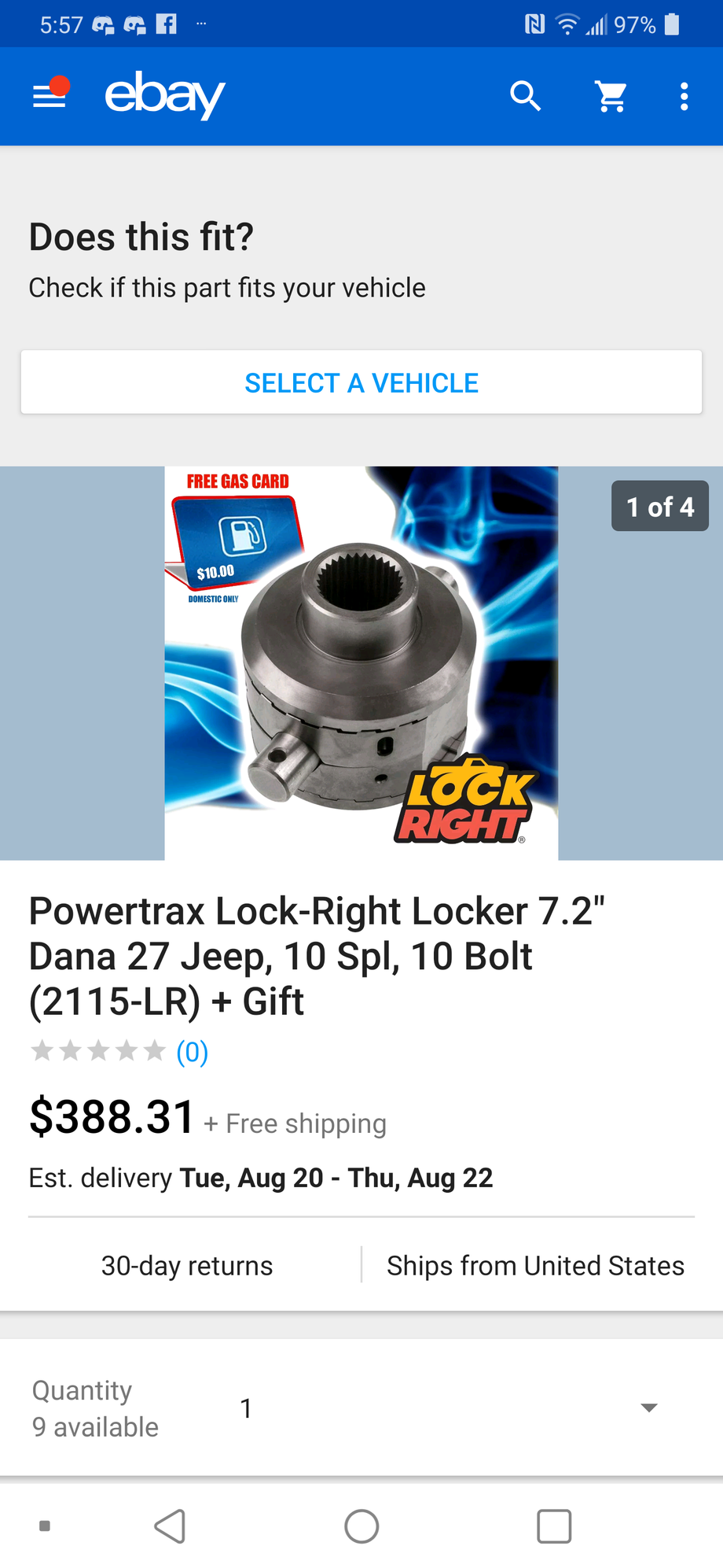

Old Aug 15, 2019 | 05:00 PM
bajablazer93's Avatar
Joined: Nov 2011
Posts: 82
From: strausstown PA
bajablazer93 is an unknown quantity at this point
I seen this but its not for a gm so it prolly wont work.
