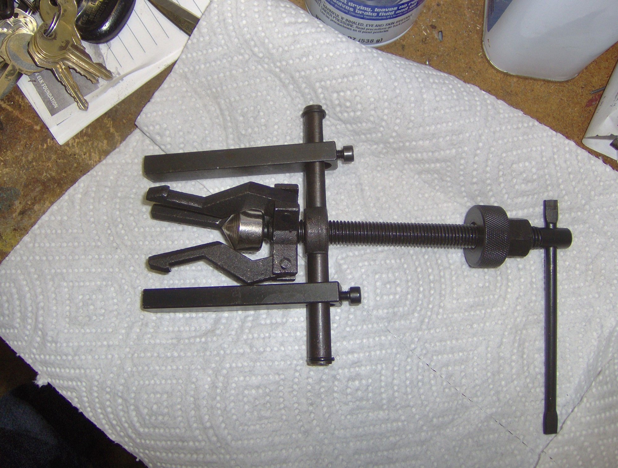

  • 3 Jaw Pilot Bearing Puller - modified for small internal clearances, from eBay

A few things to note about the bearing removal and replacement:
  • The bearing is installed with the flat face that has the stamped letters facing outward. The rounded face of the bearing faces into the differential.
  • To get the removal tool to work, I had to cut the tips off of the jaws. After I removed the bearing I realized I should have also cut an angle in what would be the outside facing parts.

Bearing removal tool before modification.
Bearing removal tool mounted in place and pulling commenced.
Modified jaws of bearing puller showing that in addition to shortening them, I should have filed down the parts that extended outward.
