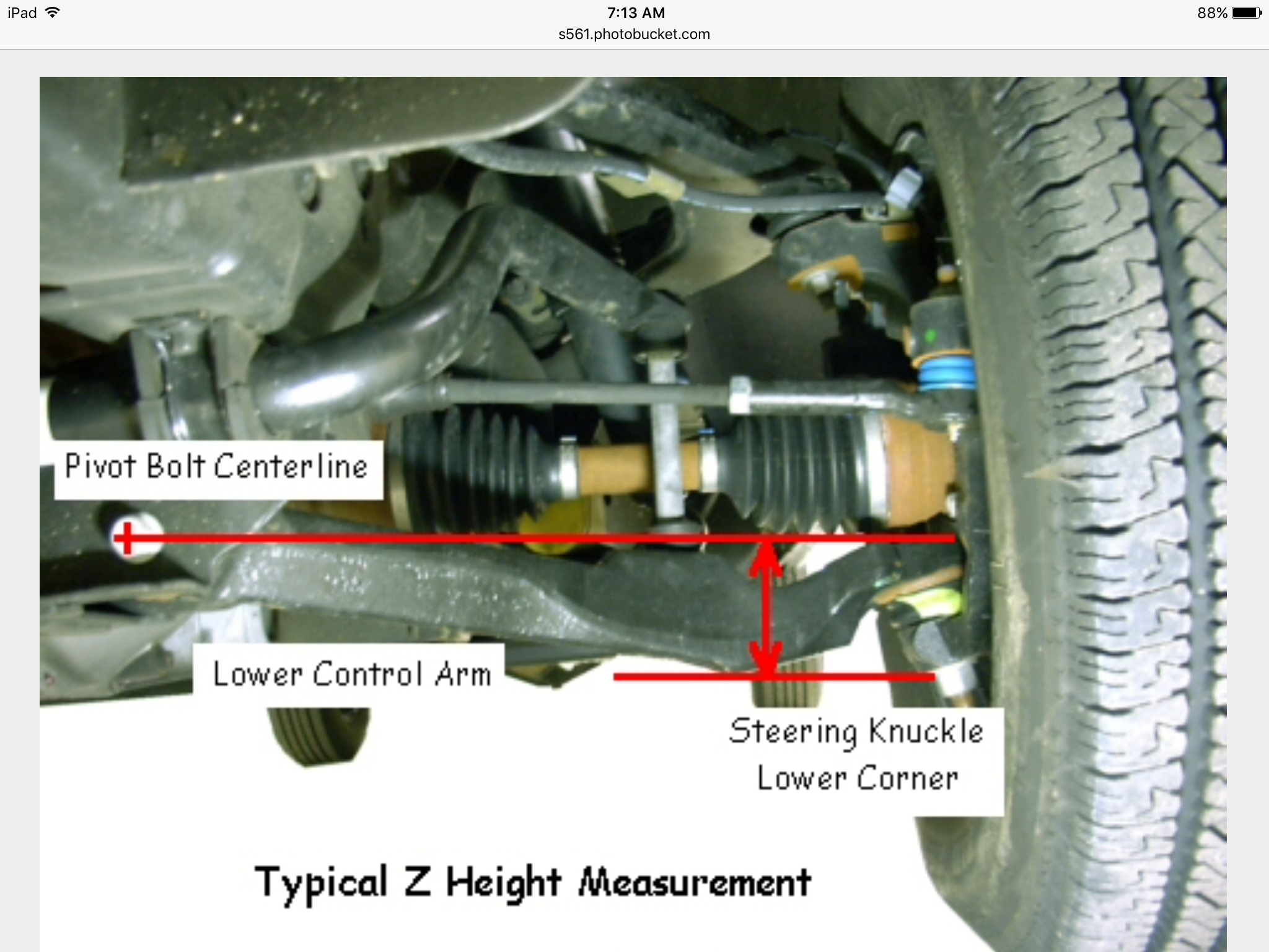

Picture stolen from Capt. Hook... as he would say you've got to crawl under there and measure it. Looking at it doesn't cut it...
Swartllk has an article in the tech section with all the specs
