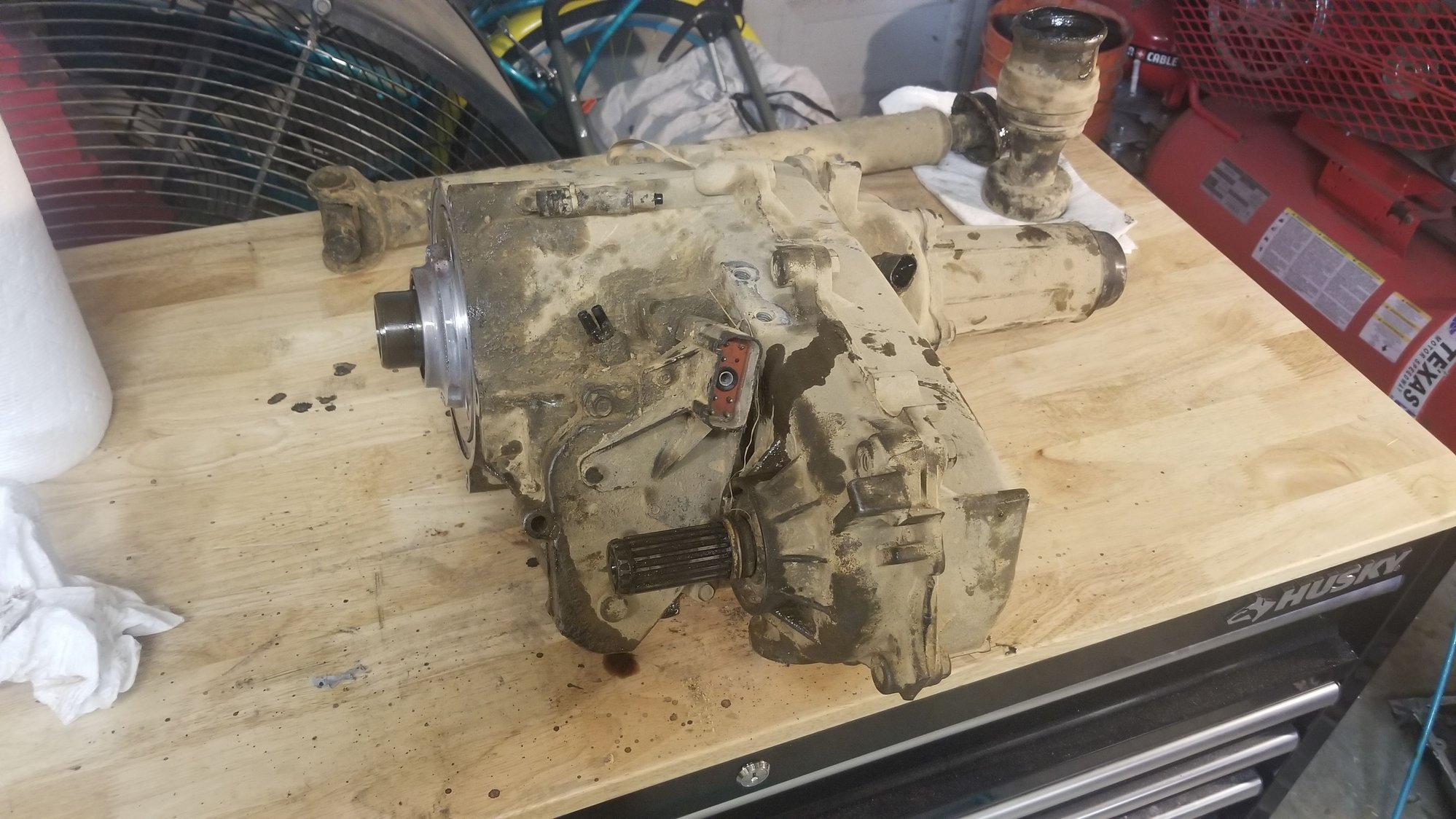

So, got the tcase dropped last night. I'll get it cleaned up, and opened up tonight, and know exactly what width chain I have

Couple quick questions.
The three vacuum line fitting is the tcase switch, for the front axle engagement, right? I've converted to a posi lock setup, so I can do away with it, right? Block it off however?
And the single hose on the top? Is that part of it also, or is it a vent of some sort?
Old Feb 26, 2019 | 02:08 PM
eshaw's Avatar
Joined: Feb 2019
Posts: 376
From: Iowa
There is a vent tube on top of the case. The other three can be capped. When you have it opened up check to see how many gears are in your planetary set. Some could be had with 6. The stockers were three I believe but they can be added to to make them six gear units. You need to know what you're looking at when adding the gears though as they come with a different helix angle on some of them. They can NOT be mixed.

Old Feb 27, 2019 | 09:34 PM
cleburne red's Avatar
Posts: 2,278
From: Texas
So, had to modify the snap rings a bit, but the tcase is open.
Ive got the wide (1.25") chain, so an xj front output won't work. Looks like my options are either a first gen S10 or Blazer, if they're fixed out put, or an early to mid 90s Dakota or ram 1500.
I've got four planetary gears, it appears, also. Not sure if I'll try to add more, I'll have to do my research on that
Also, anyone with a 4wd first gen, y'all do me a favor? Crawl under your trucks, and let me know what the front output is. If it's a ujoint, or what. I'm gonna try to go to pick n pull Saturday to get the shaft
