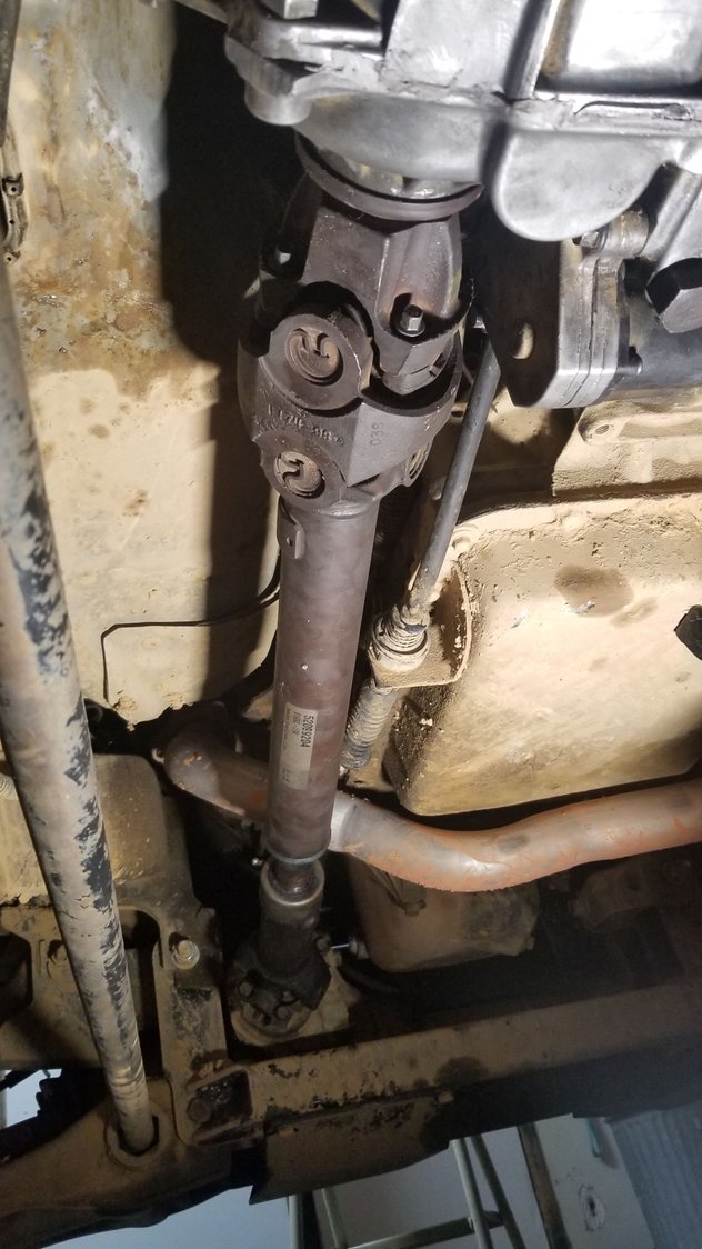

Tcase isn't fully in yet, but it looks like the Durango front shaft will fit perfectly!
Looks like a front SYE and driveshaft upgrade for our trucks can be had for <$60 at a junk yard! (plus bearings/seals, rtv, pretzels and beer, etc)

OK so it is confirmed! A 1998 5.9L Dodge Durango driveshaft will fit perfectly into a second gen Blazer! After converting the front output shaft to one from the same Durango (as long as the tcase chain widths are the same)
​​​​​​I'm gonna replace the ujoints, and have it balanced, since I plan on doing the bravada axle shaft mod soon, and then it'll be spinning all the time
