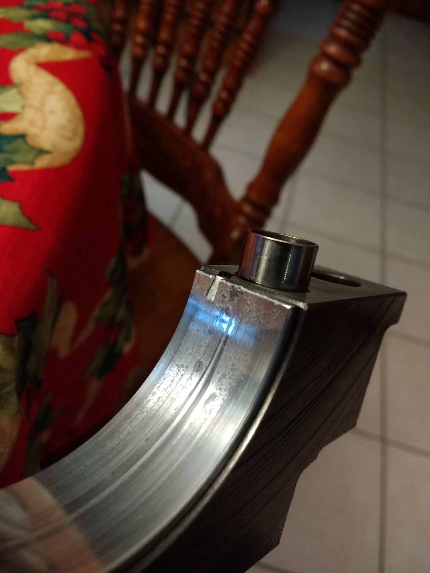

Checked my rod and main bearings and there seemed to be some surface fatigue (per Mahle bearing diagnosis guide). Note the irregular spots of missing bearing material from cracking and then flaking off. These were cheapie King bearings that came with my rotating assembly from Eagle. Had the crankshaft polished and then went back together with new Clevite HN series bearings. Left the pistons in the bores and spun the crankshaft in, so not to disturb the position of the rings.

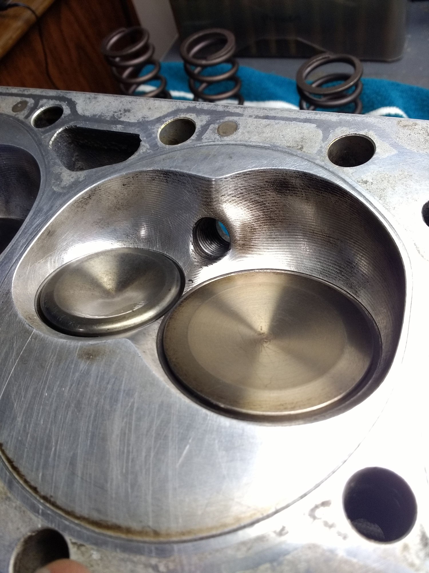

Cleaned up the ports and combustion chambers and valves with a nylon (for aluminum) or brass scrub brush (for valves) and solvent. yeah, I know I used the brass brush in the aluminum chamber a little. Checked valve face sealing with blue machinist's dye. Checked spring height to make sure was 1.800" under the spring retainer. Installed new valve seals. Installed only outer springs (this is the BEST valve spring tool in the universe) to lower spring pressure for camshaft break-in.
Next to degree the camshaft carefully and check intake valve to piston clearance on all cylinders.

Interesting that one of your intake valves sits so much higher (away) from the piston. Old re-cut seat?

Nice detail. What do you use as a plastic cap for the valve stems? I guess you push the valves through the valve seals with this not to damage the seals?
Yes, you use the plastic protectors to protect the seals from the grooves in the valves. I got a couple of the protectors from my machine shop. I think they come with sets of seals. Unfortunately I bought mine individually and didn't get any.
If you are talking about the photo with the valve with the height gauge, it's just an optical illusion caused by cheapo cellphone camera.
