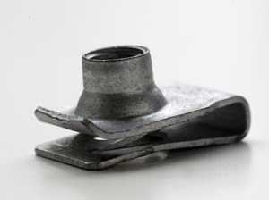

if its the same as my 96... i pulled the rubber skirts in the rear wheel well and took the air chisel to the Tinnerman u-nuts to break them free. then grabbed what was left of the nut with vise grips and pulled the bolt out.
