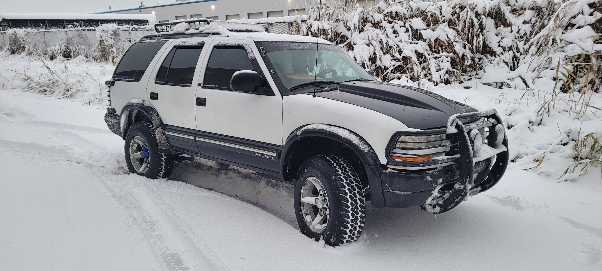

If you find some 2wd s10/Blazer rims, they will stick out as you want, And will fit perfectly in the fender flares. I'm running 30.5s on zq8 rims and the 2.5 lift. I used to have spacers on the back to level out the wheels spacing, but since sold and am going to put a zr2 axle under when its done getting rebuilt.
More pics in my build thread. And you can find the offset of a 2wd rim with a quick Google...
Here's a link with info on the s10 rims:
https://www.s10forum.com/threads/backspacing-and-offset-update.107156/
