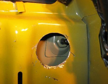

Easiest way would be to remove the plastic mold that cover the rear quarter panel on the inside of the blazer, you should see a small piece tacked to the inner side of the body.

No problem, it should be without 6-8 inches from the lower corner of the window that just above the tail light. If you dont see a piece with nuts welded to it, the you wont have it.

Here are a couple pics I grabbed from a website that showed the nut on the inside of a 2dr ZR2 that came with the external tire carrier.
