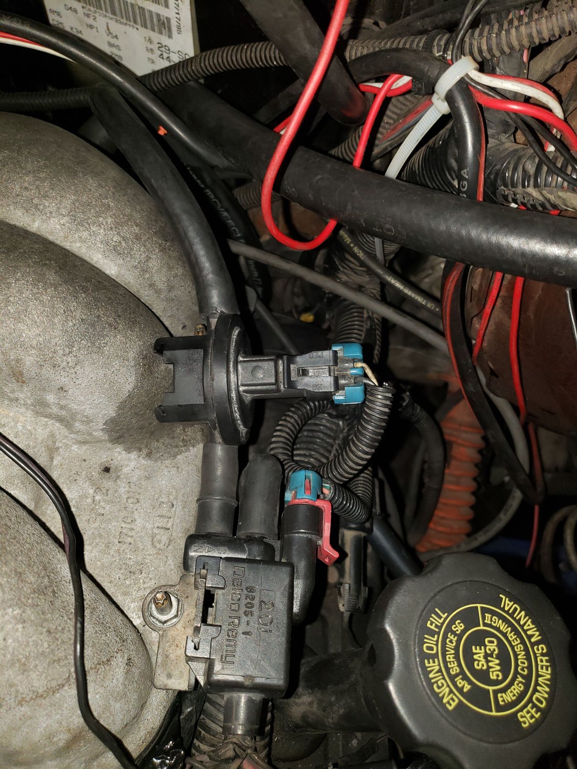

Default What does this vacuum line go to

Default Is this vacuum right? It goes to the vent line
