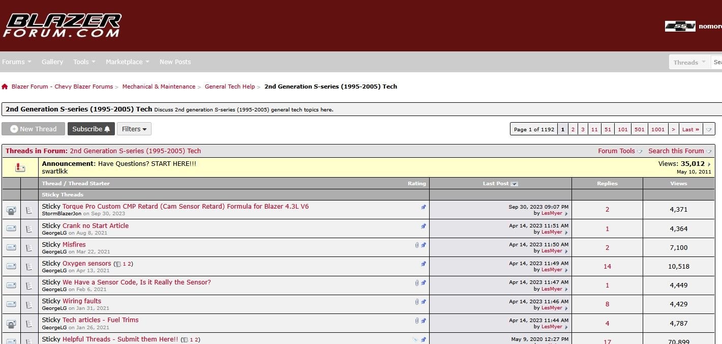

MMC- Sounds like you have some serious stuff going on there. To start a thread go through the topics and pick the one that is most appropriate and click on it. Then in the upper left you will see a box to start a new thread. And there is a search box on the upper left you can use to search current threads that may cover some of your problems. Good luck...
