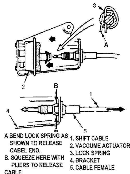

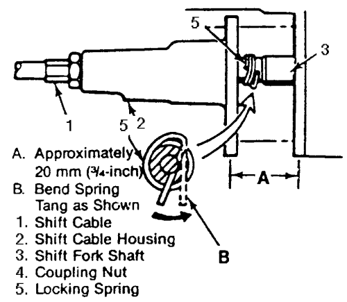

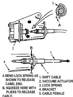

this was really so simple look at photo look the cable cost 36 dollars with tax and it connects in the same manner as the valve end just remember to take battery tray and battery out thentake valve bracket out(2 bolts in wheel well front. then take cable off in front then loosen the cable not remove it from the housing take housing off then pull or push tab on clip then remove it the clip stays on so when you put the new one in it clicks itself. Install axle end of cable first then valve end
