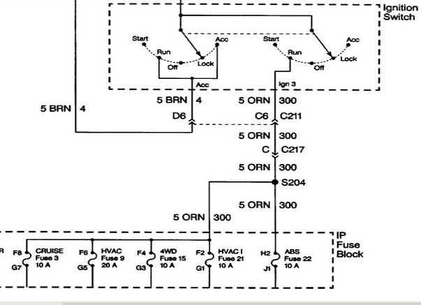

check IP hvac fuse{s}, both sides should be 12 v in run position.
-this is from my 99 diagrams. should be close but I suspect IP fuse or or block connection, not ign sw.

ok, the #9 HVAC fuse keeps blowing but I did replace the heater switch and I got the 1-3 speeds. I don't have the high speed. I tried a blower motor resistor and that didn't do it. I work at auto zone so I can preview the parts before I purchase fortunately. Besides it blowing it works, just dont have high speed and when I turn the selector it doesnt switch from vent to floor or anything. any ideas? sorry if this was resolved im writing back on my phone.

Re: the fuse..
Go under the hood and pull the connector on your AC hi press cutout switch. You're looking for two wires on the AC plumbing... probably lt blue and dk green with white stripe.
If the accumulator plug has 4 wires going into it.. may be that one.
Adn btw.. when does the fuse blow? When you put it on hi? Obviously you dont have blower at all when it's broken.

If high is the only speed not working, then the relay isn't functioning properly. High is powered through the relay only and bypasses the blower motor resistor pack.
