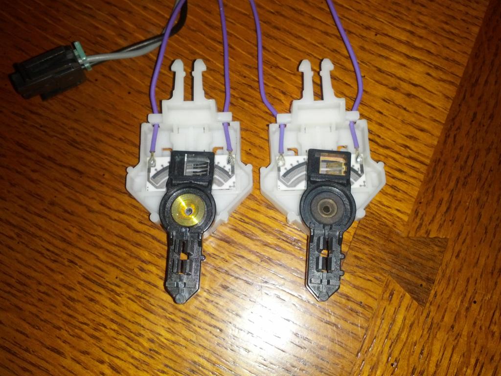

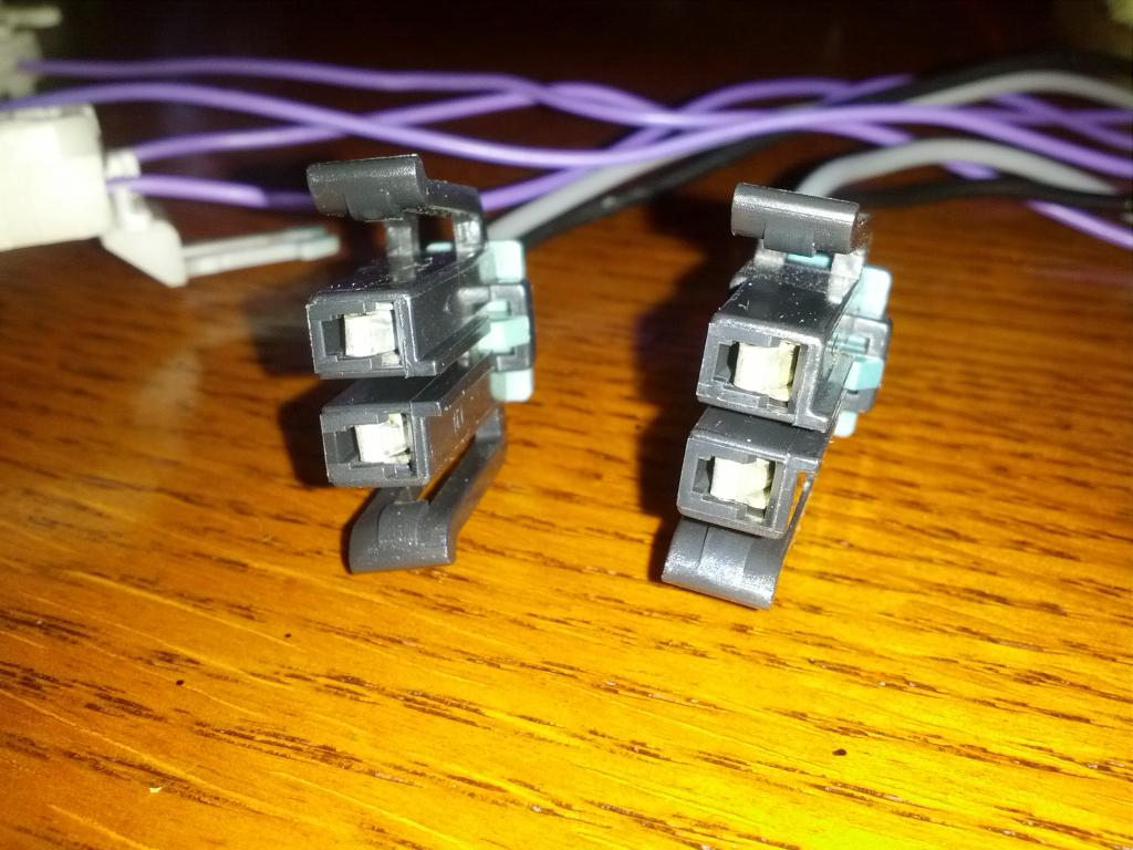

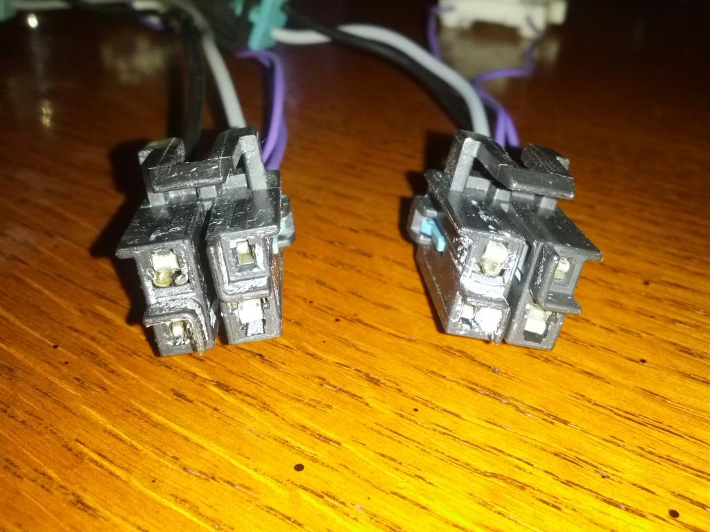

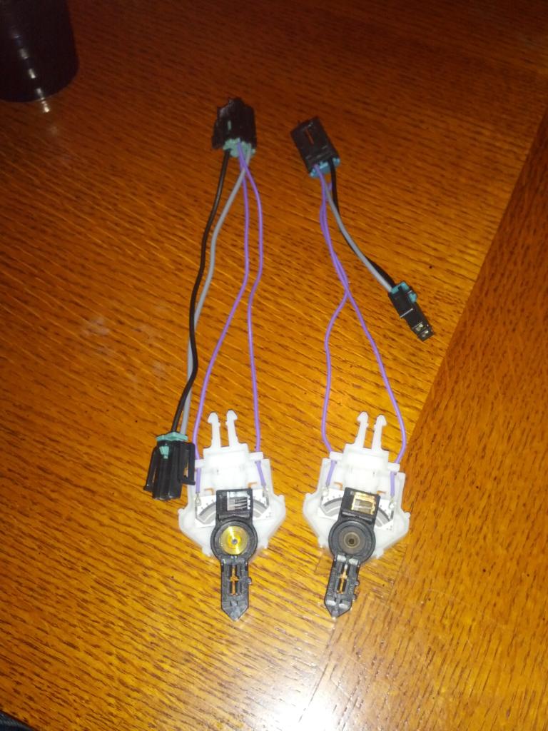

Okay so here's what I've figured out. The ONLY difference between then 2dr and 4dr level sensor units is that the 2dr has longer wires on it to go down to the fuel pump a maybe a little longer wires that are actually going to the level sensor itself since the assembly is taller. Other than that, they're identical down to the resistance through the whole sweep. Plugs at the top of the assembly and at the fuel pump are the same. Basically, you could put a 2dr one in a 4dr, but you couldn't put a 4dr in a 2dr because the wires would be too short.
So looks like I'll be putting the Delphi unit out of the 2dr (pictured on the left) into my 4dr, it'll just have some extra wire, which shouldn't be a problem at all

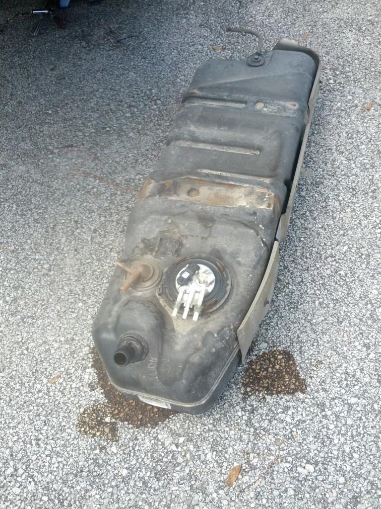

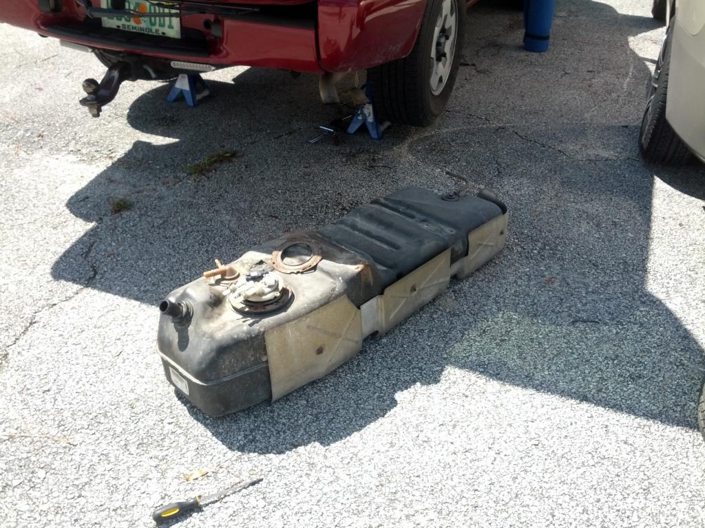

Got the tank out by 10:30, no hiccups at all, other than having to fight off ants the hole time... stupid things had a trail going under my truck... But the tank dropping process was a lot easier than I thought it was going to be, was dreading the work all week...
Got the pump out and made a discovery... I had THOUGH that the pump had never been replaced before, but I had my suspicions when I see the screw on hose clamp on the fuel filler neck... everything I had read before says the factory clamp is crimped on and has to be cut off... The real proof is when I actually got the pump out...
So that probably means I'll be dropping the tank again within 6 months to replace the pump... But hey at least I got the process down now lol

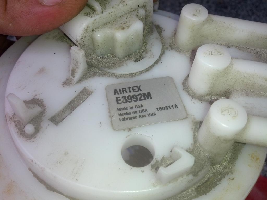

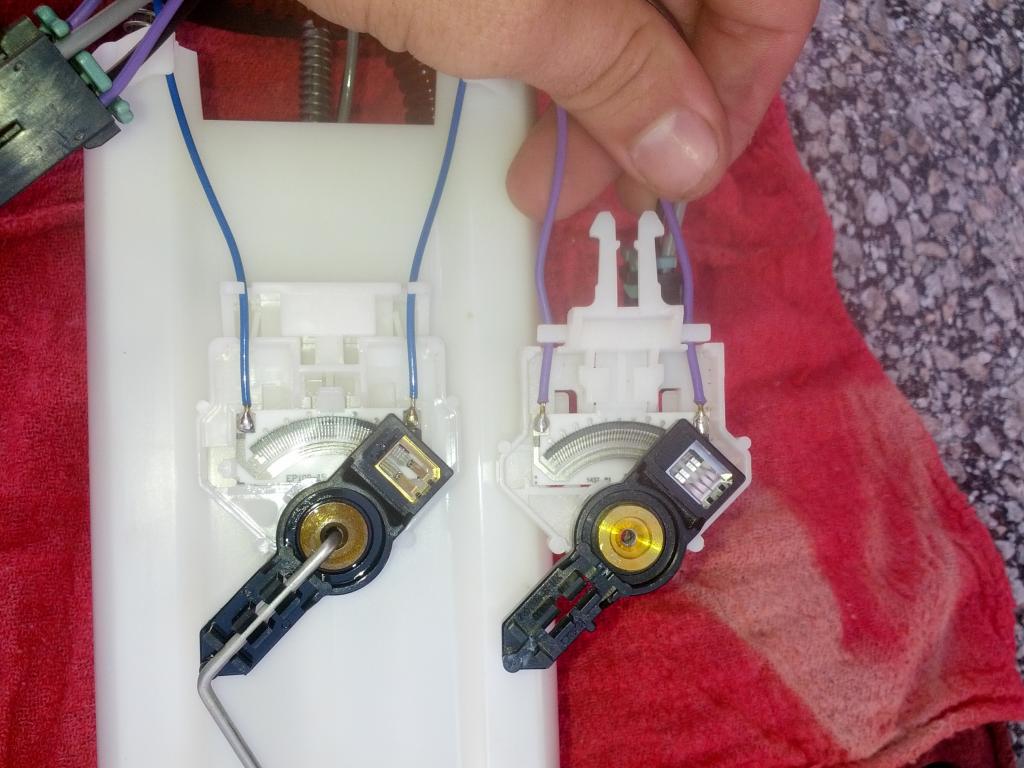

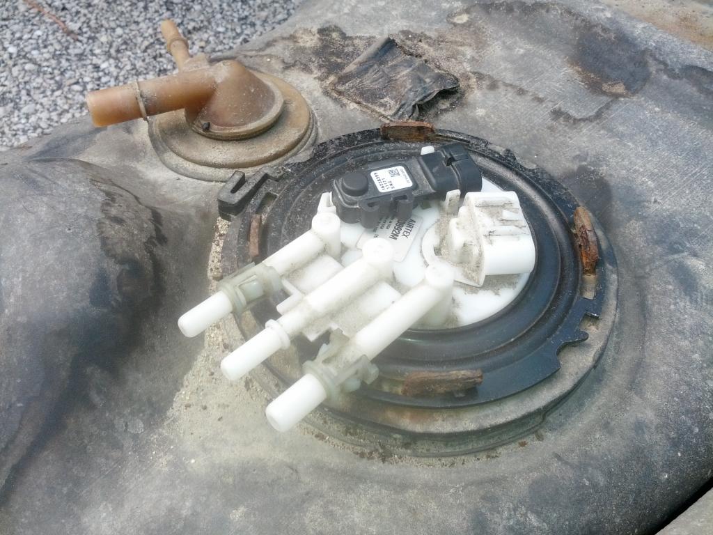

Ran into another issue because it was aftermarket... The level sensor assembly was physically different
BUT, looking close at the electronics, they looked identical. So I popped out the brass insert that holds the float arm on and was able to swap the main board and the arm.

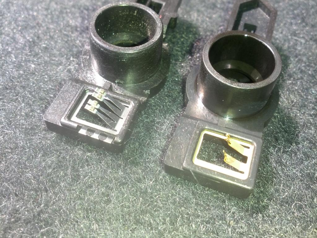

The main problem was just as I suspected it would be once I got to looking at it. The fingers on the arms were damn near completely worn off. New on the left, old on the right.
Had to swap the plugs over just by popping the pins out, but I was able to swap all the electronics without any soldering or anything. Put it all back together and it's a good things I grabbed a new tank gasket and lock ring, the old gasket was pretty hard and the lock ring was pretty rusted. Everything went back together without a hitch
Low and behold, I have a working fuel gauge now!
