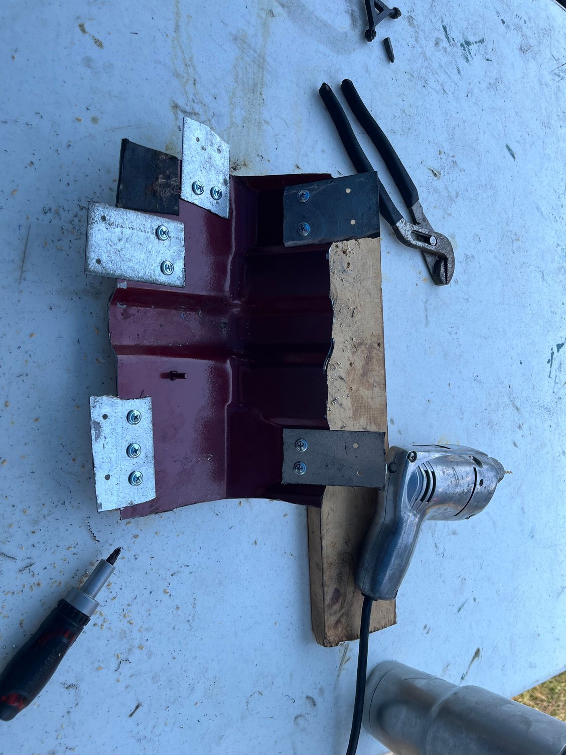

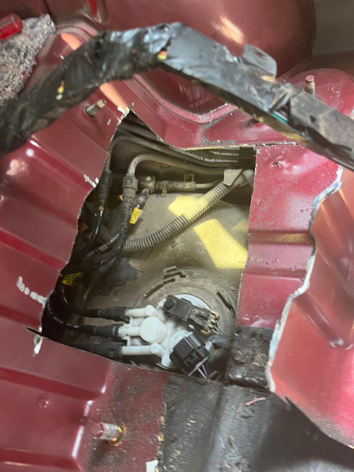

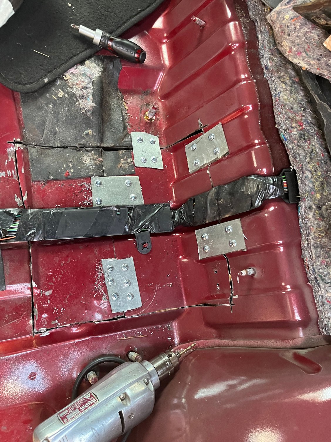

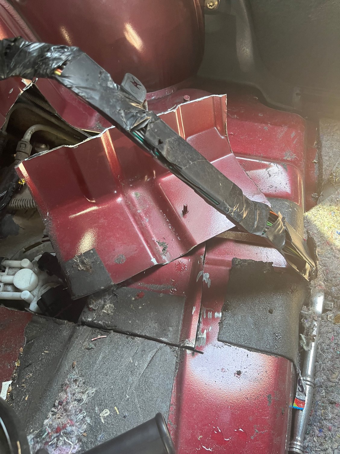

Did a 3rd attempt at getting fuel pump worked on this time I said to hell with dropping it. And saw a previous post from 2016 and followed his template and kid screwed up my first cut cause my reference point was off, but kind of improved upon the adding the plates to other side of panel, then sealed with rubber.
