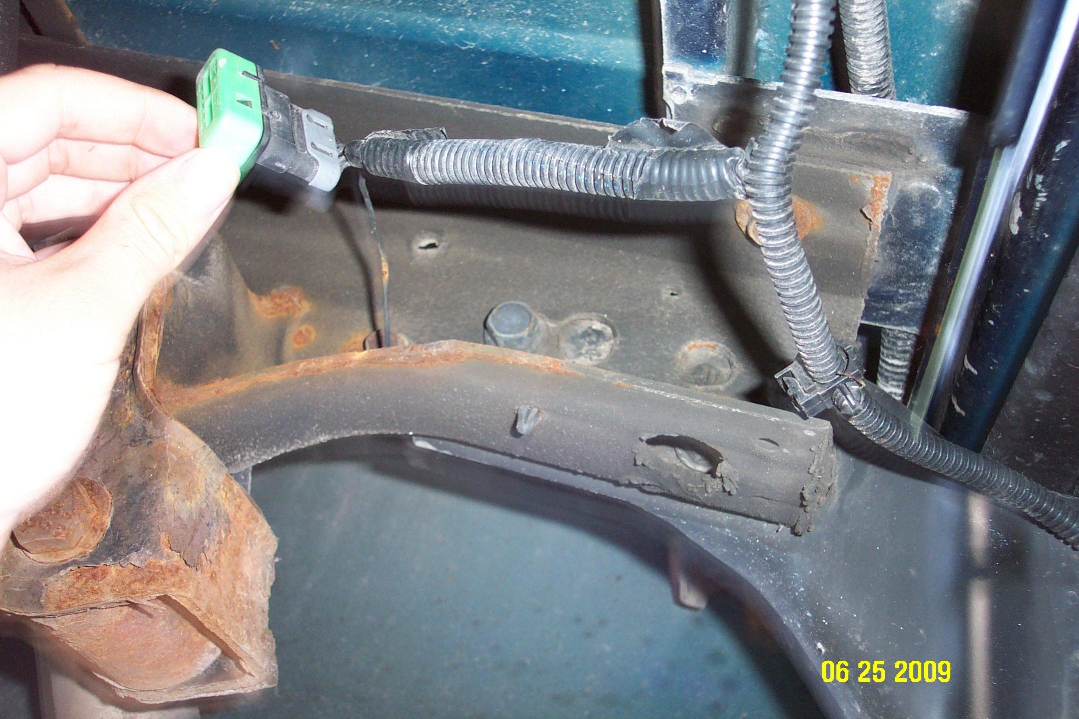

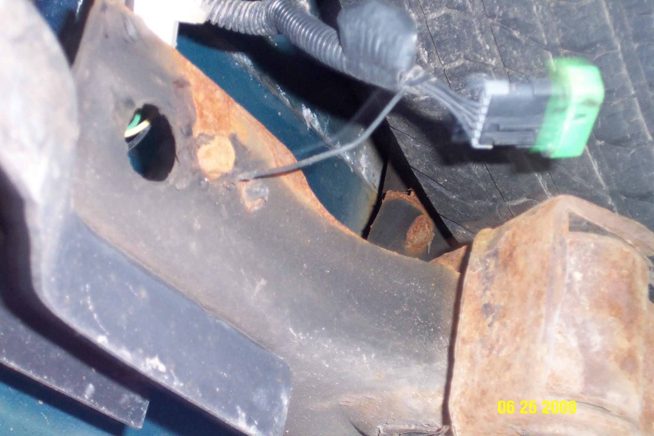

So the negative side of your lights will be connected to the frame. Under the truck behind the rear tires, on each side there should be a wiring harness that runs towards the back bumper area.
There is a single wire as seen in the pictures below that should be grounded to the frame. This is the wire that most often gets corroded or rusts off completely and gets detached from the vehicle causing light issues. And should be checked first as an easy fix before going to a repair shop.
