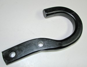

Get a frame hitch from the local junkyard. Why would you want 1 hook (2 bolts holding it on?) supporting the weight of your truck during a recovery? That would put a lot of unnecessary strain on one small section of your frame. You most certainly do not want to drill to fit this hook.

on the older s10s ive always put on the mid 90s fullsize chevy tow hooks... its been a while but i remember them almost bolting right on, i think i had to drill one hole or something.
these are the ones i use on all my trucks, including my fullsize trucks, ive never seen one break

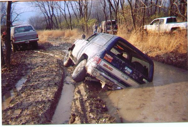

friend of mine got stuck really bad with no tow hooks, took a big block suburban like 50 half strap yanks to get him out hooked to the leaf spring shackle up front

only damage was his transmission crossmember where it acted like a plow in the mud
