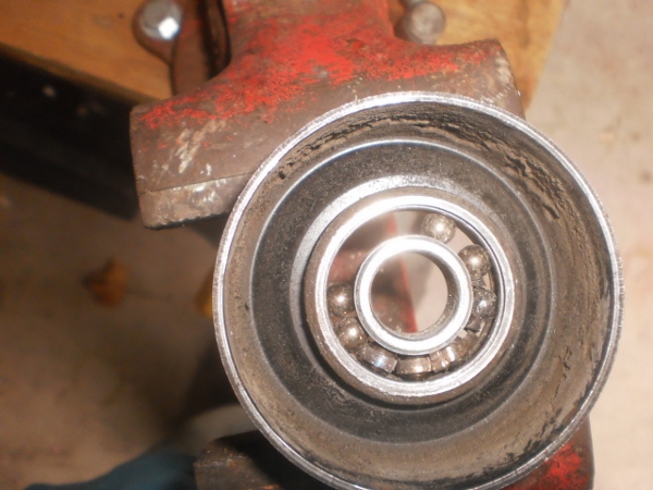

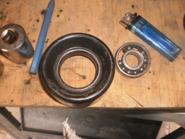

So I lossened the belt and was able to spin the idler counterclockwise, but kinda gritty sounds, and when trying to spin clockwise it only spins so far before stopping
Little update, i took the pulley off and it did spin in my hand so as a make sure I put it back on real quick, tightened it and it wouldn't spin. All other pulleys spun fine and freely and when I took the idler off again it would no longer spin in my hand.
What happens when ball bearings die
[ATTACH]Water Pump, Stuck or Dead?-2013-07-25_12-01-16_49.jpg[/ATTACH]
