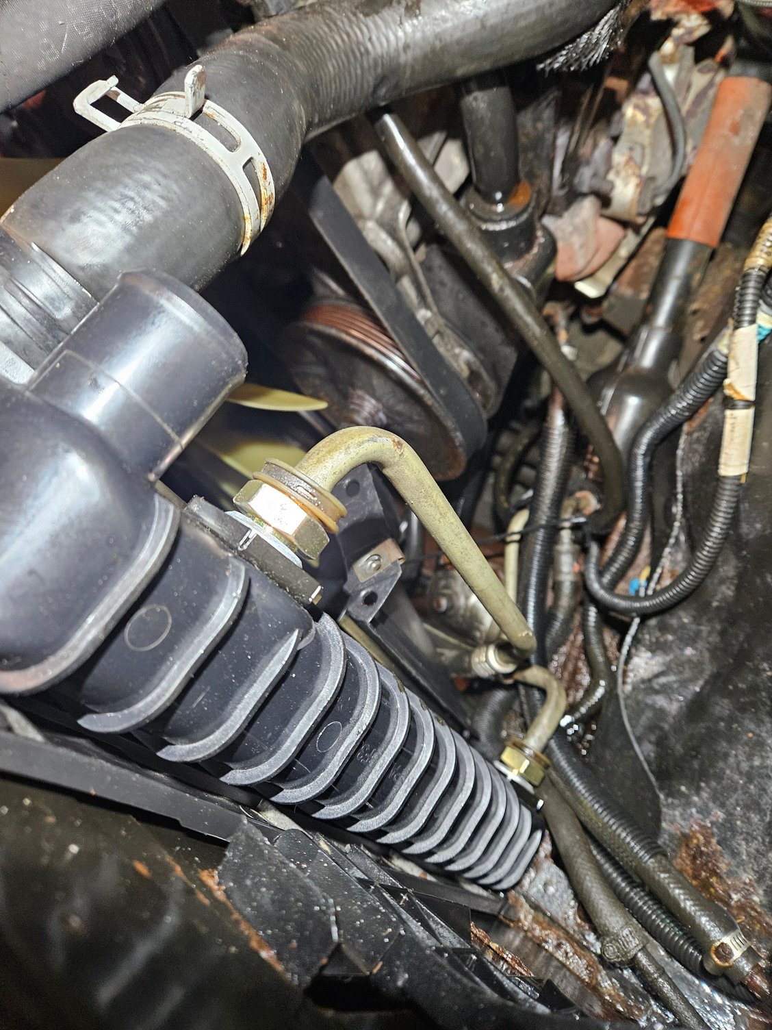

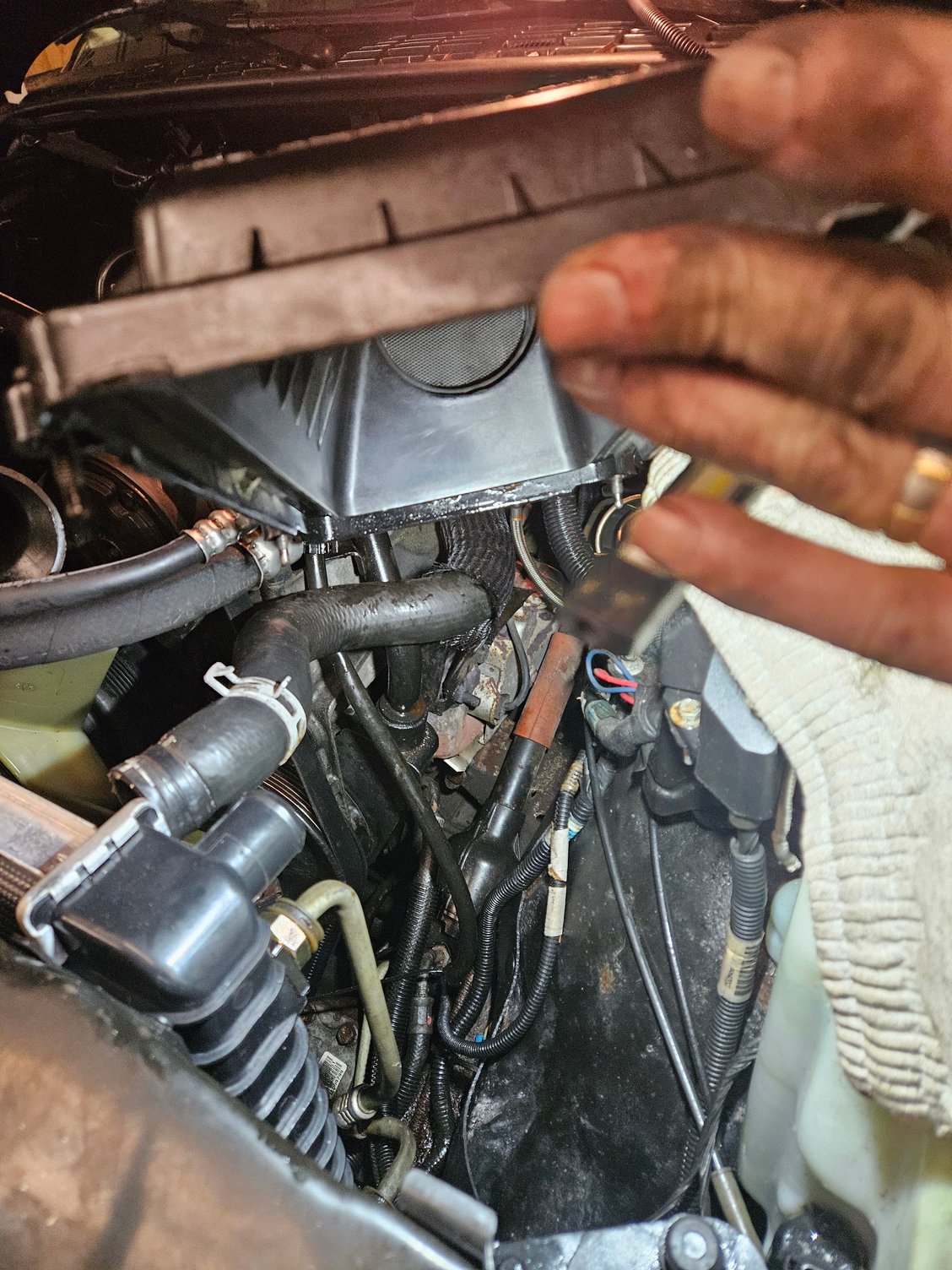

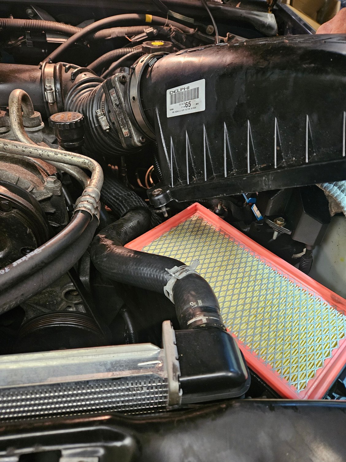

Old Feb 11, 2026 | 08:39 AM
  #60
Kona1611's Avatar
Joined: Mar 2016
Posts: 74
Kona1611 is on a distinguished road
Default Radiator leak.
I replaced my radiator with a new OEM model with the help of a friend. It fit great. There were some issues in removing my old radiator and obstacles to put in the new radiator. Things that I did not see on any YouTube or any other self help videos. So I am including some pictures showing what you have to do or what I had to do to put in my new radiator. I hope these are helpful to anyone who owns or works on a 2002 Chevy S10 Blazer ZR2 model like mine. The pics should show that in order to attach the upper coolant line I had to remove my air cleaner cover, filter and air cleaner box in order to reach and be able to put in that upper coolant line. Then you have to put the air cleaner box back in and you can put the air cleaner itself back in but then attach the upper radiator hose. Then after you have that attached that coolant line and hose you can put the top of the air cleaner back on and you have to work it underneath the upper radiator hose has the pictures show. I hope the pics and my explanation are helpful. Thank you for all the help and assistance and suggestions on how to handle my coolant leak problem. Have a gr8 day.
