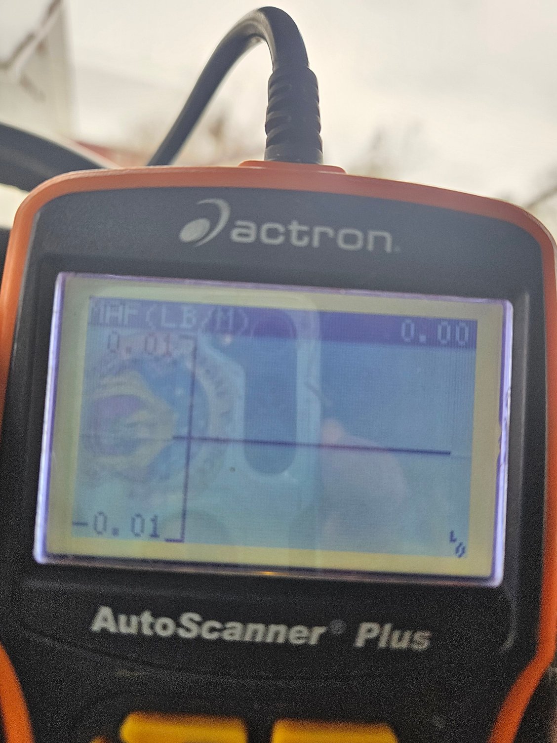

Kona1611 is on a distinguished road
Default Zr2
Hi Les. I believe it did. I used an Actron AutoScanner Plus reader and found the MAF sensor reading. I will send you a couple pics and hopefully a vid of what it said. Couldn't send vid. So pic 1 car off, pic 2 and 3 idle, pic 4 and 5 2200 rpms...double idle. Did I do this correctly? Plz let me know what this means about my code P0101. I expect that it has nothing to do with the two other codes. As you say one code at a time. Thanks again for all of your help always. Hv a gr8 day.

Did the P0101 come back after you cleared the codes?
Yes, you found the MAF sensor reading.
For a given RPM it makes a big difference on whether you are at high vacuum (holding steady with pedal) or at full throttle. All your measurements so far are at high manifold vacuum.
Normal idle speed on a Blazer is about 550 rpm and MAF should read about 4-5 g/sec at that idle. Yours is 1.61 LB/min (on your scanner) @ 900 rpm = 12.2 g/sec. If you ratio that down, yours would be 7.4 g/sec @ 550
I would say MAF seems to be working but possibly reading a little high. We can ratio down the reading at 2100 rpm and check it too. 2.85 lb/min = 21.5g/sec @ 2100 rpm. If you ratio that down yours would be 5.6 g/sec @ 550 rpm. So in that case it would be normal.
The other thing you need to do is to watch for highest MAF reading on a full throttle 1-2 shift. Please report.
Also, does it always idle at 900? What about in gear? Should also be about 550.
