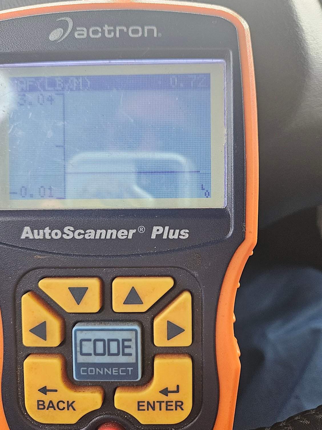

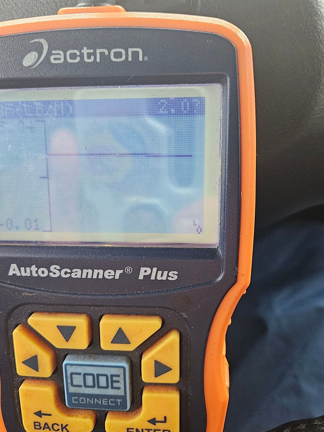

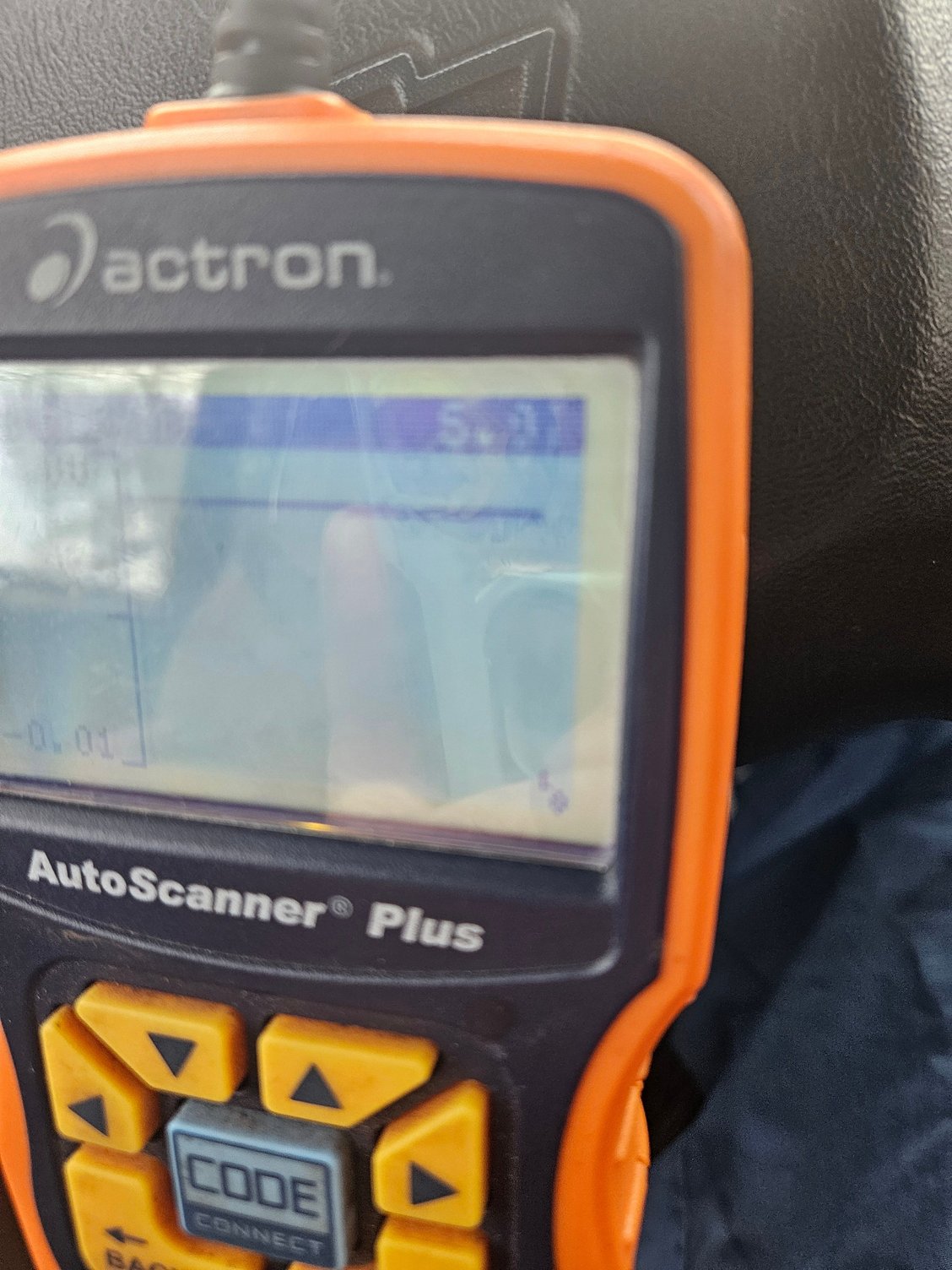

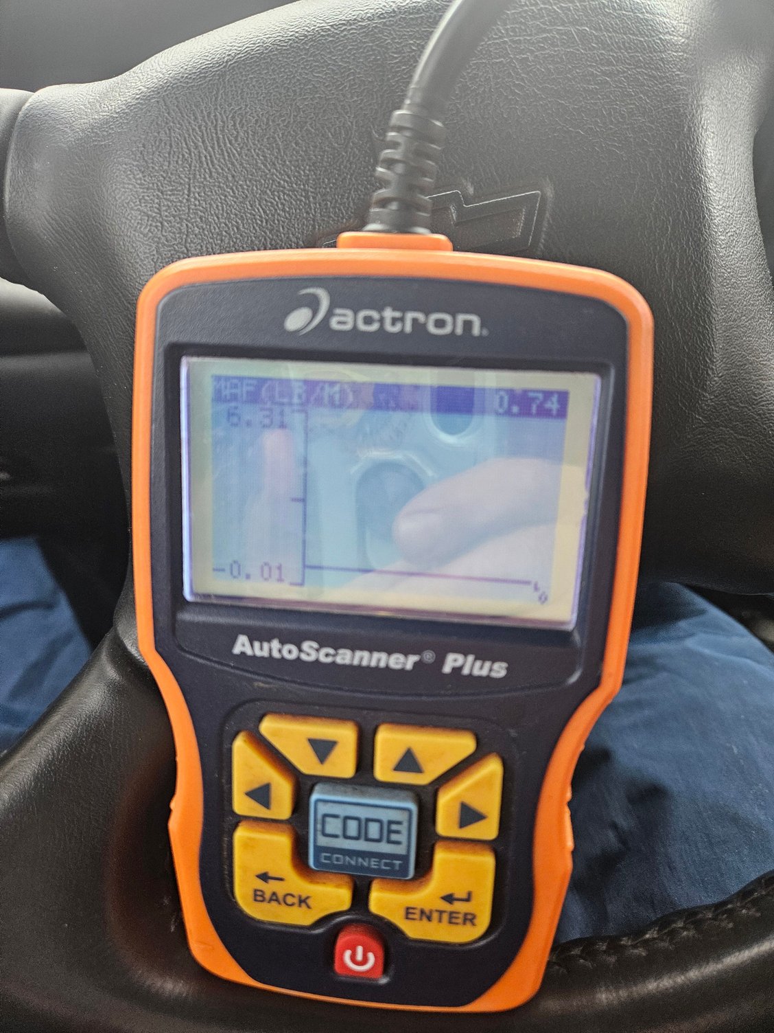

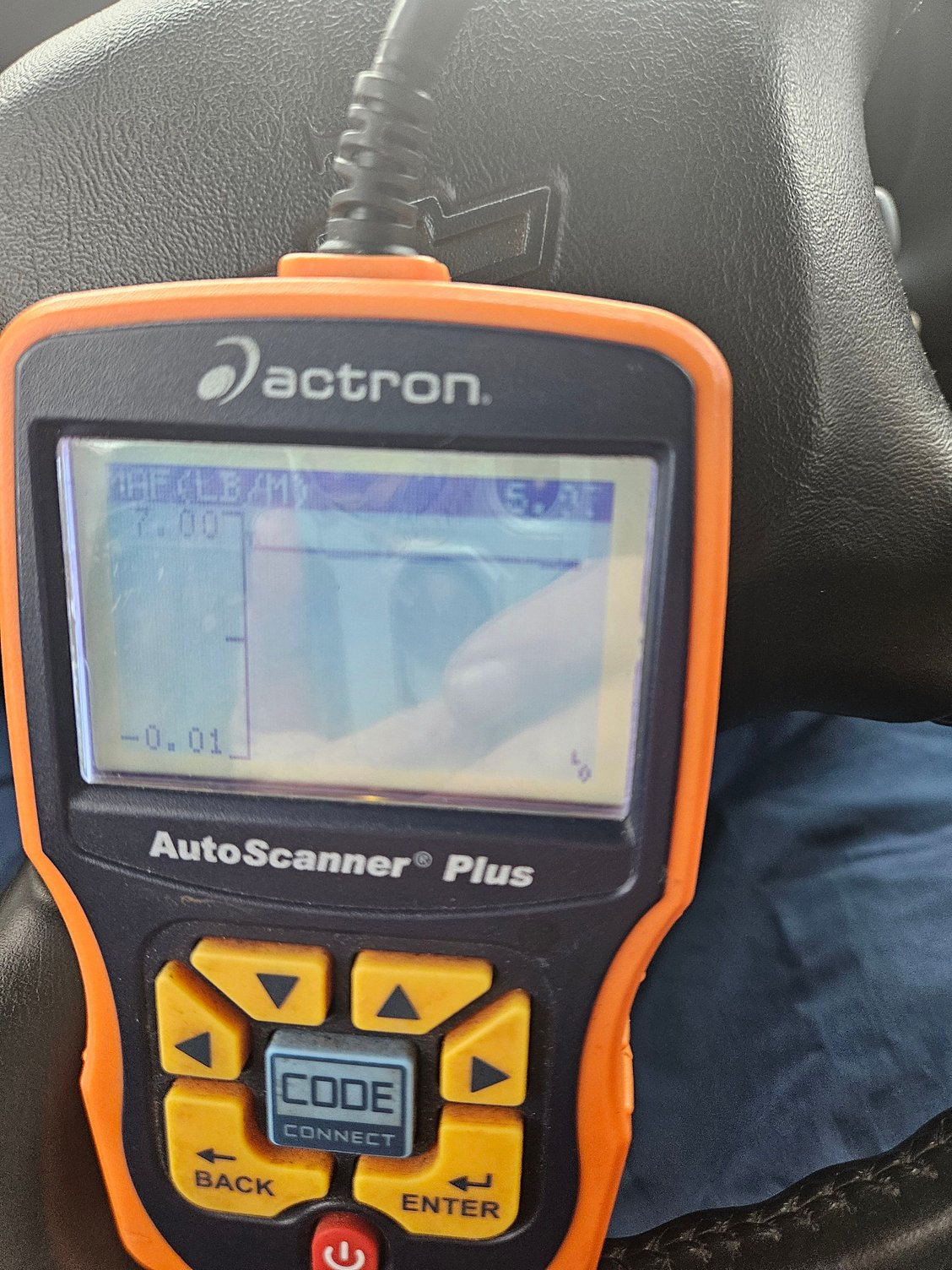

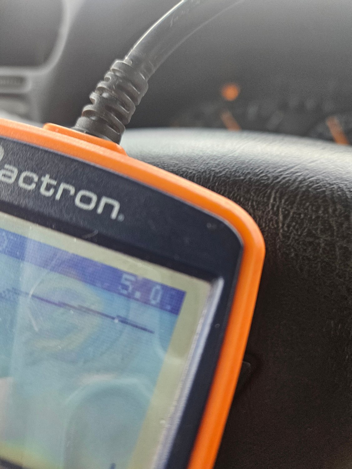

Here are my new readings. I let my vehicle warm up..its 22* outside here in Ny State. I am attaching pics. 1and 2 at idle. 3, 4 reved up and held steady, 5 & 6 driving, 7 & 8 parked at idle. 9, 10 idle in gear, 11 & 12 full throttle or near it...13, 14 idle again.

The first pic is out of order...It should be the last pic..full throttle. Sorry about that. I think all of the rest are in the correct order. I hope this is helpful. Do you think taking out the a MAF sensor and spraying it with the MAF sensor spray will be helpful? Thanks for your help. Hv a gr8 day.

Did the P0101 come back after you cleared the codes? Did you remove the airbox again and check the snorkel position?
I want to get the answers to these questions out of the way before going on. I've asked for them several times.
5.83 lb/min = only 44 g/sec. If this is your reading at FULL THROTTLE 1-2 shift, then MAF reading is quite low. Should be above 130 g/sec. If you weren't at absolute full throttle, then test means nothing. It also doesn't mean the MAF sensor is bad, as restricted intake or exhaust or even other sensors can cause same low readings. I'm betting that either the snorkel for the air box is pinched or the catalytic converter is plugged (you said at one point that you was getting a P0420), but we haven't finished the diagnosis yet on anything, so please don't jump to any conclusions.
p.s. you don't have to take photos of everything. Just type the readings from here on out.
